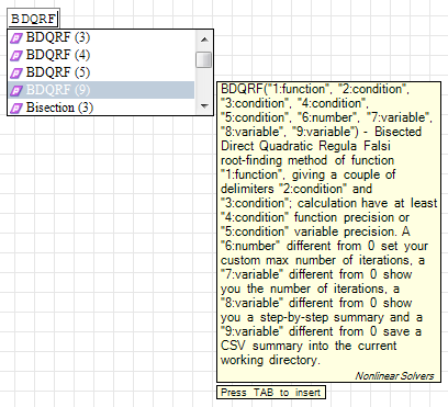

trySolve(Term[] function, Term[] bound_P1, Term[] bound_P2, Term[] epsilon_fx, Term[] epsilon_Δx, int maxIterations, bool showSummary, bool saveSummary, ref Store context)
Better you look below for documentation; code entry point is accidentally close to the high-level function, but in general this is not guarantee
Activebook (Tools > Plugins... Interctive books - Online Gallery > Interactive SMath Handbook)

For plotting issues, I suggest to scale down the values (f.e. plot f(x)/10^19 or something similar)
