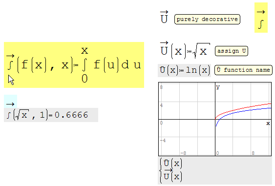

#7 Опубликовано: 06.05.2023 11:47:36
Asked a long time ago.
Unfortunately no possibility found so far to set vector arrows
over letters.Only over printed documents
You can slide any decoration over a variable name
... or over a function definition ... even an arrow !

#9 Опубликовано: 07.05.2023 09:42:47
Hello Jean,
How do you enter the arrow, Hat, etc. above such that the two are together and move together?
Basile
You can have some circomflex hat as well from Charmap.
All or most Charmap can bear function name, even single arrow.
Take care Basile ... old Collab ... Jean.

#10 Опубликовано: 07.05.2023 14:26:16
... the document for eventual projects.
Cheers ... Jean.
Maths Symbols DECORATION Copy.sm (17,26 КиБ) скачан 1267 раз(а).

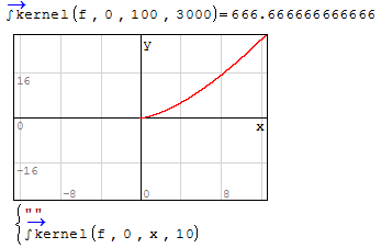

#12 Опубликовано: 08.05.2023 08:33:43
You can have 'arrow(s)' as variable name
Take care Basile ... Jean.
BasileArrow.sm (28,75 КиБ) скачан 1294 раз(а).
