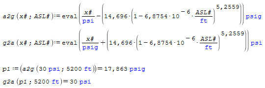

I thought I was clear. Compressed air is my example and I used Denver @ elevation 5200 ft. 1 atmosphere in Denver is 12.2 psig not 14.7 psig so 1 atmosphere is relative to the elevation. When you work any math out, we should be using absolute values. With temperature, it's better defined and we have deltaF or deltaC for ease of use in formulas.
All math is in terms of pisa and I need to convert psig
#4 Опубликовано: 08.04.2018 14:58:00
Let the psi unit be psia and introduce an undefined unit psig with appropriate conversion functions.
This approach prevents you from mixing both types of pressure representations, because you would get a unit mismatch error.
It doesn't, however, prevent you from adding psig values, which might not be a good idea.
All in all this is a conversion very much like between K (absolute) and °C (gauged), just with the nasty difference that the offset isn't constant and has to be specified whenever a conversion is to be done.
psig.sm (5,42 КиБ) скачан 1339 раз(а).
