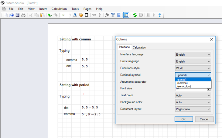

- while setting dot for comma, after typing comma a multiplication appears. Would be nice if, after typing comma here, the dot comma appears. In the opposite way it works.

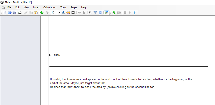

- the area name should also appear at the end of the area shouldnt it? And if I could close an area at the end of it too, that would be great.

Multiplication exists in 3 styles [2*ln(x), 2.ln(x), implicit 2ln(x)
Smath style is unique 2.3.4.5.6.7.8.9=362880
Implicit style is confusing.
coma [,] or [;] for arguments separators.
What is an area ?
In Smath, you insert an area to collapse math/text/image ... regions.

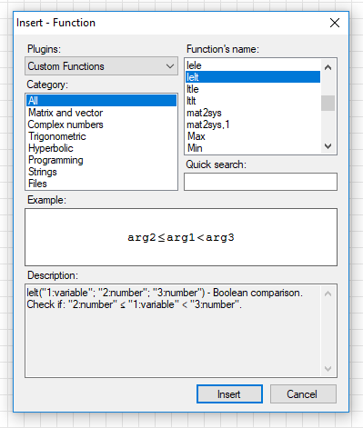

typing more boolean alike without that irritating clips to appear
Just to clarify, parentheses in booleans were introduced because often calculations of newbies were affected of wrong statements in if() functions, where you might be tempted to use something like a
BTW, if neeeded, in Custom functions there is a set of functions that wraps ternary comparisons:
I should explain that with a picture.

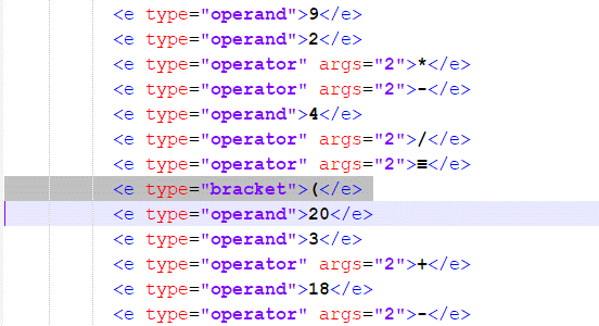

Hi. Or can hack the sm file deleting where "(" appears:
HackingEqual.sm (3,3 КиБ) скачан 1788 раз(а).

Hi G-Tate. Difficult. I edit the sm file with a text editor and delete the "bracket" lines:
Thanks very much!
Thats a nice trick to know.
