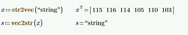

Is there a method within SMath for converting between strings and vectors of Unicode Points (or ASCII codes)? That is, a means of accomplishing what Mathcad's str2vec and vec2str do?

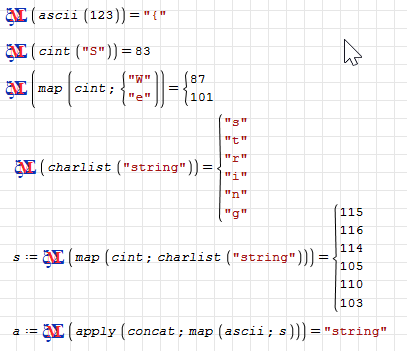

You can use Maxima.
string.sm (5,5 КиБ) скачан 1209 раз(а).
Отредактировано 21.09.2025 21:16:32

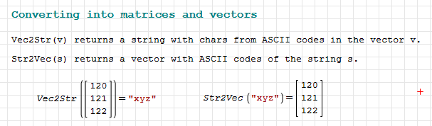

Hi Stuart. Nice to read you. You can use the functions in this post: https://smath.com/en-US/forum/topic/bppdgC/String-utilities, which, while not very efficient, at least get the job done.
