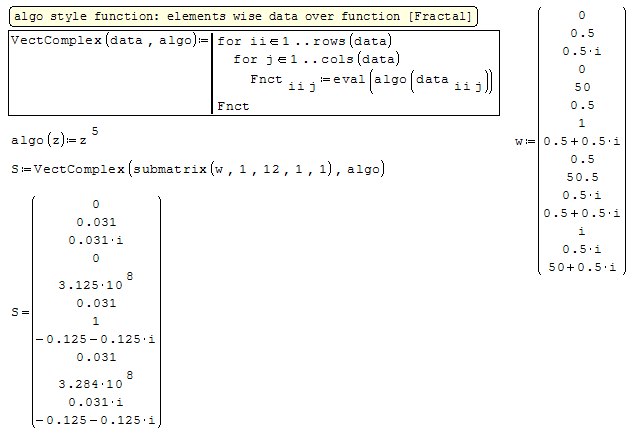

I recently discovered, that if I use vectorised operation on result of submatrix(v,...) and sort(v) functions,
vectorised operation doesn't work, it needs eval(submatrix(v,...)) and eval(sort(v)).
The optimization of the code is, of course, NUMERIC.
Another thing that happens, if I use NUMERIC function, returning something like mwexp(vector),
further SYMBOLIC calculations don't work with the result. I need to specify return value as eval(mwexp(vector)),
then it's OK. It might be intended behaviour, but it looks a bit fishy.

WroteI recently discovered, that if I use vectorised operation on result of submatrix(v,...) and sort(v) functions,
Vectorize function will not work for functions which requires matrix/vector as argument only. We have briefly discussed it here: http://en.smath.info/forum/yaf_postsm30971_SMath-Studio-0-98-5908--05-March-2016.aspx#post30971. As you see for now I have advises not to implement exceptions for such functions. That is why you need to use eval() there.

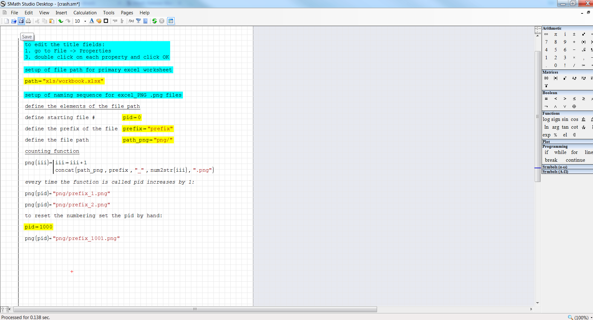

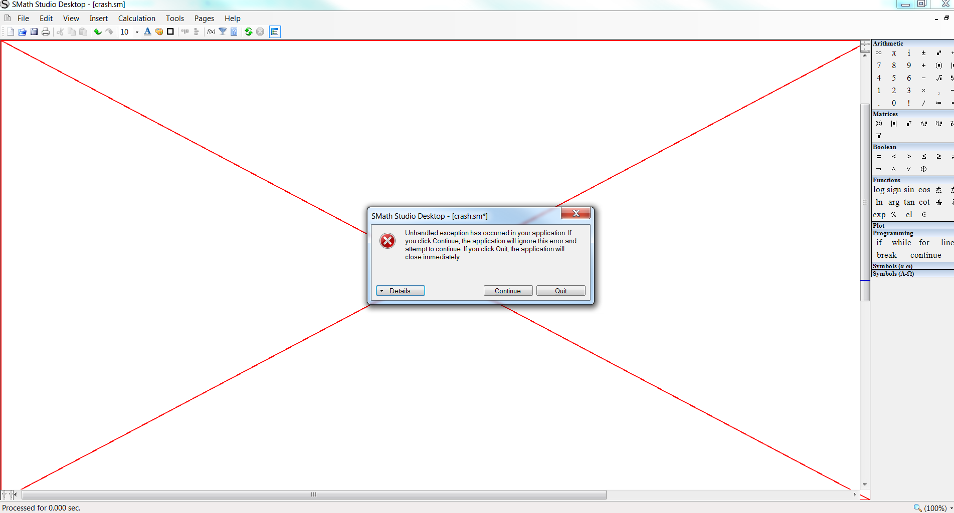

Crash is related to presence of page background image bg.png.
Fresh install of this release is used on Win7 Enterprise SP1 64 bit.
I am encouraged to use company logo / title block on all my work so I will revert back to 0.97 till this is resolved.
crash.sm (38,4 КиБ) скачан 1630 раз(а).
WroteIf I try to save attached file with the cursor positioned below all the text, it will crash.
Fixed. Thank you!
