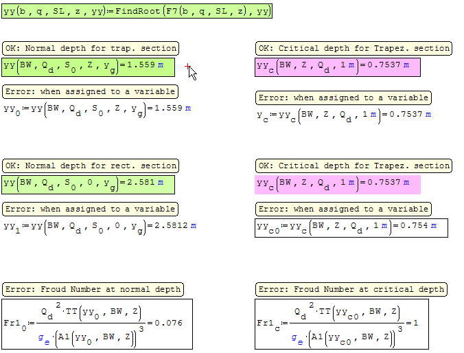

Hi
The "Open Channel Design" file attached earlier had erros inside the program section in calculating the critical slopes for each bed width. The corrected program is attached now.
Regret any inconvenience.
Now I observe that the result of FindRoot function unable to assign to a variable in attached SS file.
Test_FindRoot-1.sm (40,22 КиБ) скачан 1277 раз(а).
Above file was extracted from the original file Channel Design-using FindRoot-R1.sm (206,01 КиБ) скачан 1298 раз(а). for testing, but both had the same problem
under SS 0.98.5981. However, it was perfectly OK when I uploaded on 18th Oct. 2015 (cannot remember the SS version).
As Andrey has suggested, I did a clean installtion of SS, but the problem still exists.
Another isuue is also shown in the image.

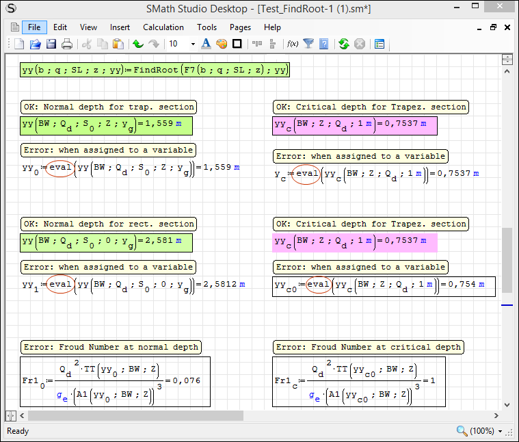

#3 Опубликовано: 18.05.2016 10:07:09
It works, version 5346 UNofficial distribution

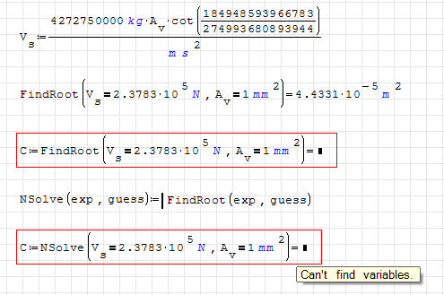

Well I tried... It is still not possible to assign a value to a variable using FindRoot(). This nightly is officially broken for me - I NEED A WORKING SOLVER.
Back to stable release...
BugFR.sm (6,15 КиБ) скачан 1332 раз(а).

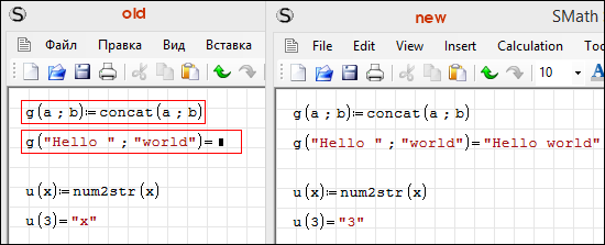

So, new build is here: http://en.smath.info/forum/yaf_postsm34488_SMath-Studio-0-98-5990--26-May-2016.aspx#post34488
It has corrections related to this topic.
I suggest to update plug-ins according to this comment: http://en.smath.info/forum/yaf_postsm33336_SMath-Studio-0-98-5973--09-May-2016.aspx#post33336
I you have to use not updated plug-in please give a chance to eval() function:
Why these changes are done:
Regards.
Davide Carpi 26.05.2016 20:05:00

This still does not work:
I am a little needy here, because without a working FindRoot() function I am left without a solver that I can use to assign values to variables. I do this all the time in tasks similar to... How many stirrups do I need in this RC beam?
Hope you guys can get me the FIndRoot() back :-)
... A peculiar occurrence. If you place the cursor inside the first red box and hit Ctrl + >, the 2nd red box will evaluate correctly. Magic!!???

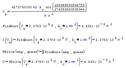

#17 Опубликовано: 03.06.2016 02:55:30
with Smath 5346 UNofficial release. No idea if it makes sense ?
#18 Опубликовано: 05.06.2016 19:19:30
I cannot reproduce neither with version 1.0999.5 of the plugin nor with later versions (strange). I suppose it may have sense, in some way, since undefined variables are store as names. However the second result is wrong, so something definitely goes wrong in that case :/
