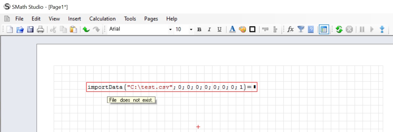

and enter to the SMath Studio importData function:
but there is an error "File does not exist". I changed function arguments as you can see at https://en.smath.com/forum/yaf_postst539_importData-and-exportData.aspx , but there is no effect.
What's wrong with my file?
Version Smath Studio 0.99 (build: 7579).

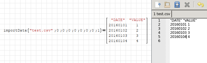

I couldn't recreate the problem.
Everything seems in order.
Tested under linux.

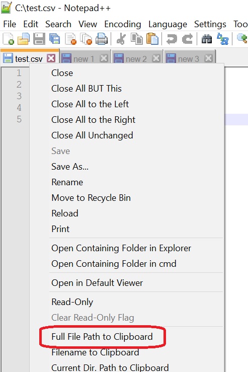

I copied path to my file with context menu of notepad++
So when I paste path to Smath I can't see difference between manual path input and copy-and-paste it. Picture is the same. But when I copy formula back to the clipboard - it's differ when I get it:
Цитата
importData("C\003A\\test\002E\csv",0,0,0,0,0,0,0,1)
importData("C:\test.csv",0,0,0,0,0,0,0,1)
Upper line is copied from notepad++ and it's not work whith the exception above. Next line is manual input and it's work fine.
