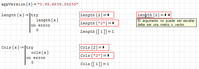

Hi. There are not try-catch here.
#2 Опубликовано: 05.10.2018 21:01:23
There are not too many applications in this forum.
It works numerically ... visit this application.
Image Rotate RGB Copy.sm (349,18 КиБ) скачан 1285 раз(а).

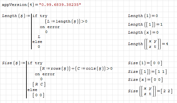

#3 Опубликовано: 06.10.2018 09:21:26
This seems to be a workaround for the bug.
Length_Try_Catch.sm (8,18 КиБ) скачан 1297 раз(а).
Functions like this Length, and equivalents for Rows and Cols are a standard way in Mathcad to check if one works with matrices or scalars, avoiding the use of IsMatrix (absent in SMath at this time), and saving some program steps.
PD: Try-catch is the name in Maple and others for the SMath try-on error.

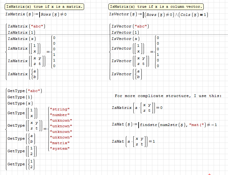

With this version of IsMatrix you catch the length for symbolic matrices. Also, avoiding the use of strings have some advantages over the simple version, here as IsMat.
Length.sm (48,89 КиБ) скачан 1307 раз(а).
#7 Опубликовано: 30.10.2018 12:35:13
Described behavior of the try...catch is by design.
In your example length(x) calculated symbolically and does not raise an error. You can check it by calculating length(x) with symbolic optimization.
To have the behavior you want please use eval(lenght(x)) instead.

#9 Опубликовано: 31.10.2018 07:40:04
Hi Andrey. Thanks for the clarification. I guess that the origin of this behavior is from about which is the "default unassigned variable type" in SMath. In maple and mathcad it is a complex number, but in SMath it seems to be a matrix or anything else
Unassigned variables are considered as unknown type; there were problems in the past because they were consider scalar or matrices...
I suggest to open a separate correction request here or in the bug tracker to improve behavior of length/rows/cols when a matrix contains unknowns...
Alvaro 31.10.2018 21:57:00
