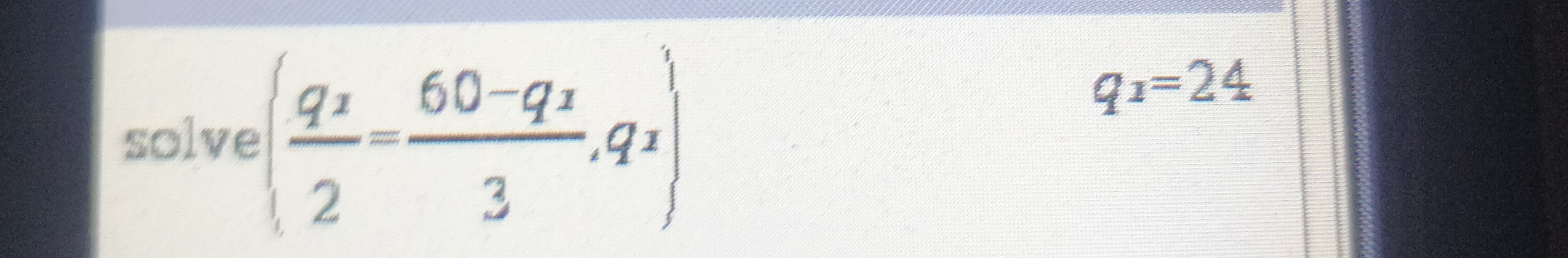

Is there any way to solve proportion's like in TI-nspire cx? (look at picture)

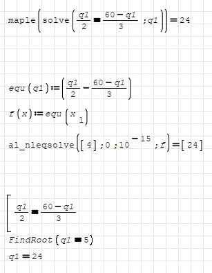

with Maple
or with Maxima

Thanks realy much this help lot!

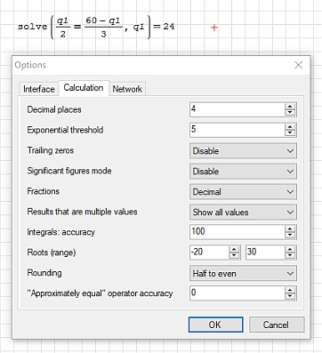

Hi. In addition to the churichurro solution you can also use SMath native solver after changing the roots range.

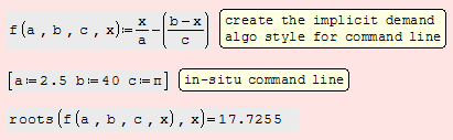

In addition to Razonar's reply;
You can also determine solve() range within the function itself.
You can also use roots() and FindRoot().

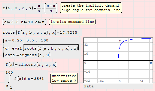

There are also plugin solvers.
Maxima can be added to collection as well.
