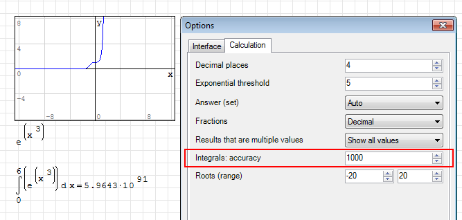

You have to increment the accuracy of the integration.
This option is available in: Tools > Options > Calculation
