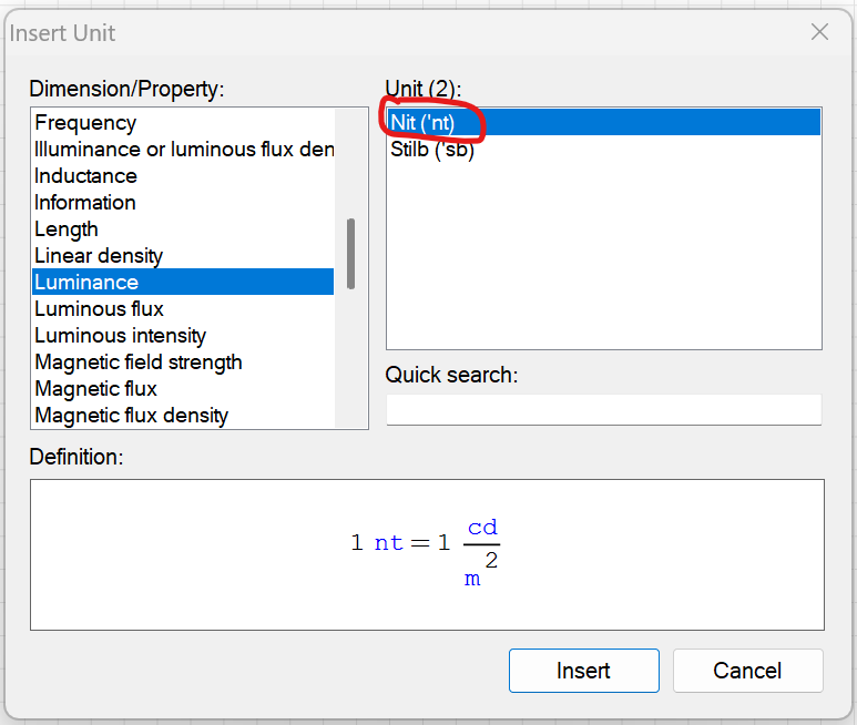

The non-SI nit unit of measurement added to the Luminance dimension;
New unit of measurement added:
