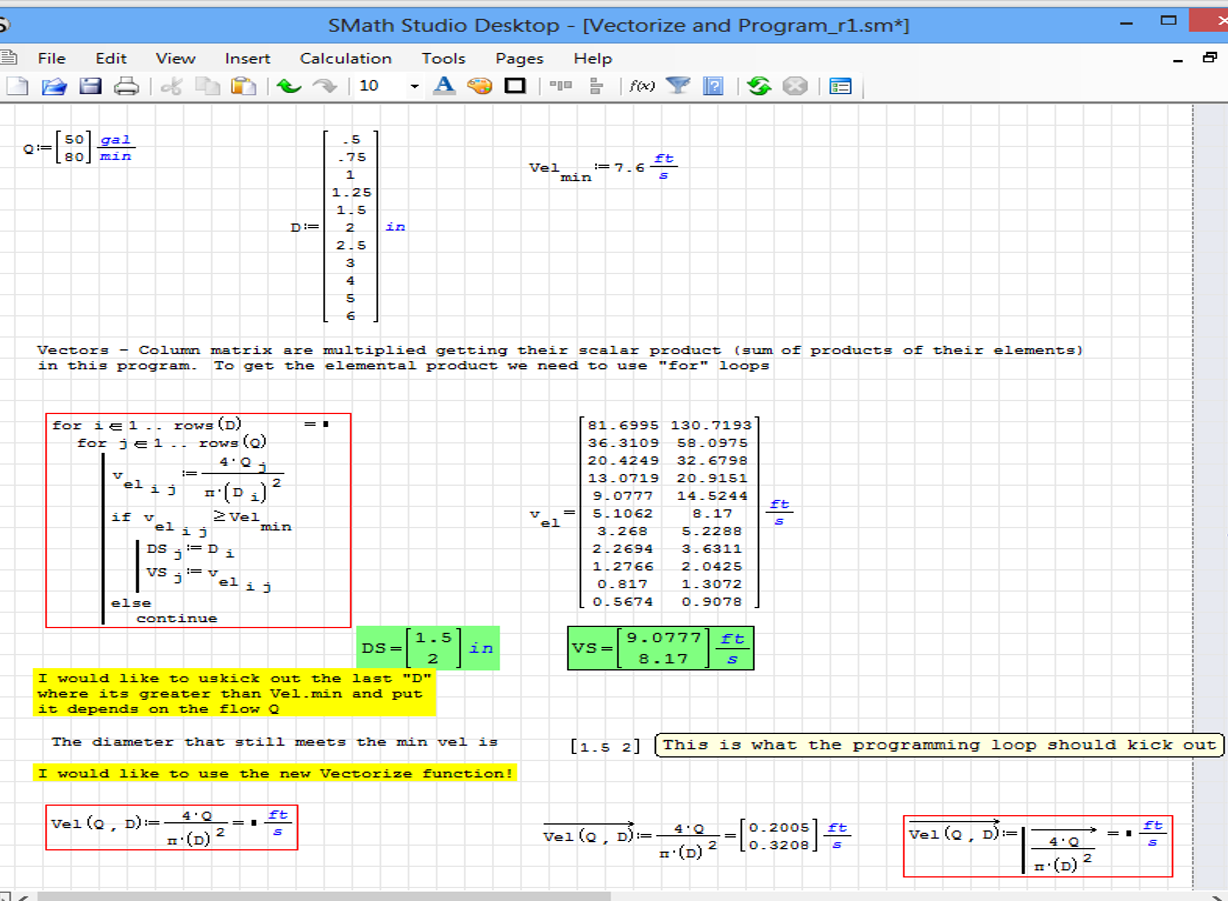

Jean will be proud (algorithm) and disappointed (would like to use vectorize)
I would like to know two things ... Vectorize and Program.sm (14,29 КиБ) скачан 1295 раз(а).
1) Can I convert my algorithm and use vectorize?
2) I want to pull the diameter that corresponds to greater than Vel.min

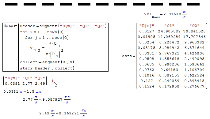

You can supply the data table to piping designers, and live them finish the work.
In 1987 and earlier, piping designer used a glorious software "Massbal"
At this time, none of these computing gadget existed. Vectorising does not apply
in your project. Smath is not equipped to search in table. For a unique scientific
application on long data table, one would have to design a lot of modules.

Thank you. Never used Augment before ...
Not for the piping designers, for me to double check other calculation. Everything is off of "packaged" software and I like to double check the maths. Curious if a second routing can be used to solve for the the D. If V.i,j>V.max keep solving, else, stop. Putting kids to bed and will look into that

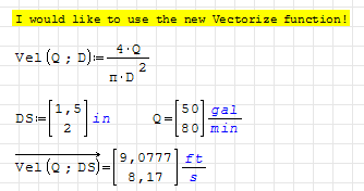

Just remove erroneous declarations, and use DS in function invocations (your D variable is defined having 11 rows, Q has 2 rows, you should use DS having 2 rows).
Vectorize and Program.sm (14,58 КиБ) скачан 1312 раз(а).
P.S. My screenshot is just a follow-up of previous suggestions (Jean's and CBJ's).
My sheet is another approach without any loops, just vectorize() end eval().

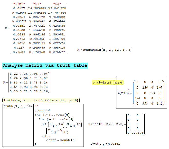

In that project, there are two erroneous concepts:
1. Non SI systems are too specific. Behind the scene, the General Chemical Engineer
does lot of conversion to accomodate the low level Imperial team work in some way.
2. I Chemical Engineering, they don't use volumetric flow rate: they use "mas flow rate"
... Jean , I want 10 t/hr of water @ 100°C ... all that will come into my orifice
plate calculations. I better take into account the water weight density @ 100°C.
The error would be immense on the top of an unknown [+/-] 0.6%] error from the orifice plate.
From what I can see, tabulating some sort of useful data will be the other way around .
The first column is the Q [massflow rate], from which you calucalte the speed versus
the diameter. So, there will be as many speed column as there will be diameters.
Doing so: the data table will be visual for checking. QA controllers, they don't care
gadget calculations, they go by the book. Also, consider what a CAS like Smath can do.
The truth table is not a gadget, it is almost the only tool to search in data table
that dont have integer values , though you can round off but can't surely round the speed
to integer values.

- CBG, you counter was what was perplexing me the most. This is originally what I was after Answer.smz (3,22 КиБ) скачан 1272 раз(а).
- Jean, you always say to be get inspired. After looking at your table, I expanded on my output Answer with Table.smz (3,64 КиБ) скачан 1273 раз(а).
