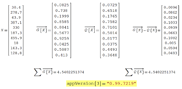

#1 Опубликовано: 08.11.2019 05:08:51
NDTM Amarasekera
NDTM Amarasekera

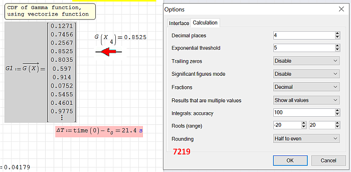

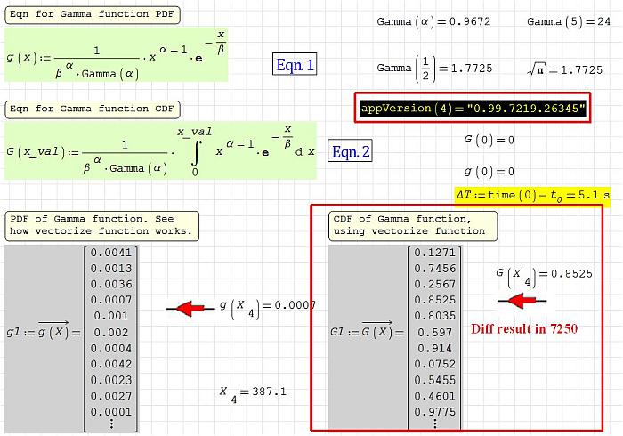

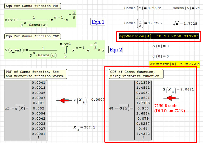

Thank you Andrey for the Latest Beta 7250.
But, the attached SS File yields an error due to different result of
integration in 7250 compared to result in 7219.
SPI_Calc_Plain.sm (111,38 КиБ) скачан 1298 раз(а).

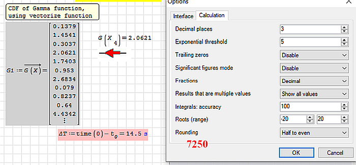

#2 Опубликовано: 08.11.2019 06:13:29
Do you have the same settings about integrals' accuracy in both the versions?
#3 Опубликовано: 08.11.2019 08:20:08
NDTM Amarasekera
NDTM Amarasekera
Yes, same settings in both versions.
But the difference is in Eqn 2
#4 Опубликовано: 08.11.2019 12:15:57
Thank you very much! It was a real calculation error I've introduced in 7250.
Fixed in 7251 (will be available very soon).
UPDATE: Released here: https://en.smath.com/forum/yaf_postst17461_Beta--SMath-Studio-0-99-7251--08-November-2019.aspx
Best regards, Andrey Ivashov.

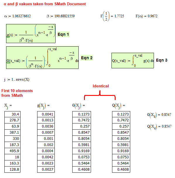

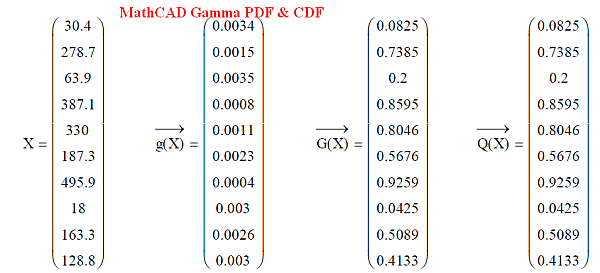

Integration results of Mathcad attached (using first 10 elements of X
and Eqns 1, 2 and 3.)
SPI_Calc_Plain.sm (125,02 КиБ) скачан 1314 раз(а).
Rainfal_Data.xlsx (486,32 КиБ) скачан 925 раз(а).

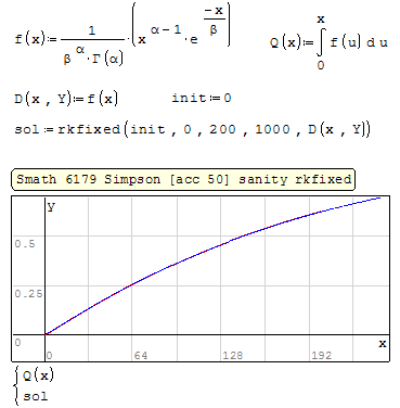

#7 Опубликовано: 10.11.2019 11:01:56
What I understand from your previous reports is that
the Simpson integrator is kaput again in latest SS version.
What more is kaput ? SS 6179 does not open your attachment.
In the mean time, can you doctor rkfixed your document ?
NDTMA.sm (54,8 КиБ) скачан 1223 раз(а).

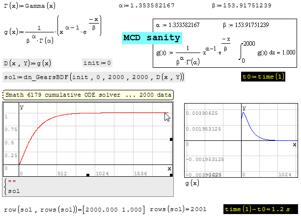

#9 Опубликовано: 11.11.2019 10:59:00
Thank you. I will try my best ASAP.
In the mean time following files are attached.
Here is doctored sanity MCD.
Don't forget Smath Gamma(x) is only globally 4 decimals,
immaterial in your CDF integration. If you need to check
the peak location of PDF, we have the Golden ratio algo.
Enjoy ... Jean.
NDTMA Test Gamma.sm (45,33 КиБ) скачан 1267 раз(а).

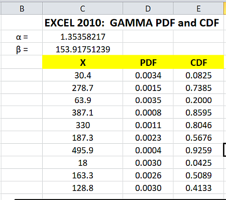

#11 Опубликовано: 12.11.2019 07:07:16
NDTM Amarasekera
NDTM Amarasekera

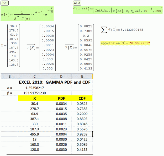

Sincerely, I was trying to show that results of Gamma Function CDF
in 7251 were not compatible with 7219.
I wish to add that similar working in 7219 reasonably tally with MCD and EXCEL,
while 7251 is not so. I believe that may be the reason why I got errors using
SS ICDF.normal function in SPI calculations (some CDF values>1 ??).
Anyway, I am attaching the following files and images for further examination please.
Many thanks to all for their comments.
Fimal Gamma Results.zip (1,14 МиБ) скачан 406 раз(а).

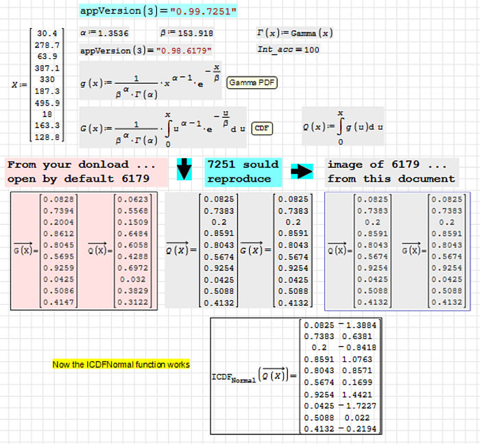

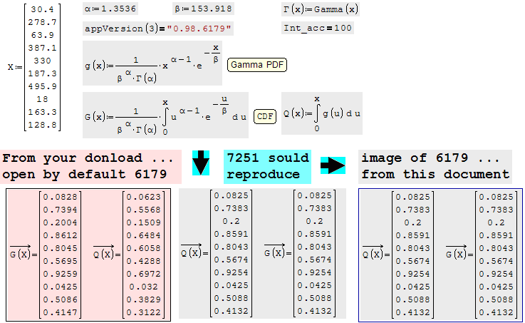

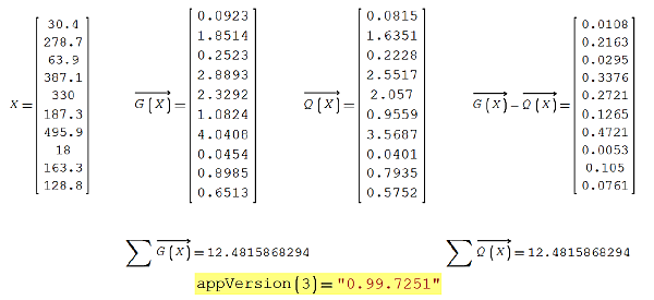

As you say ... hard to doctor this patient.
Your download opened by default on my 6179 carries the bug.
Could it be the vectorize operator is the cause ?
If so: that would be quite a bug !
Test_Gamma_7251 [6179].sm (22,54 КиБ) скачан 1172 раз(а).
It worked! Thanks, but how?
Test Gamma [2] 7251 [6179].sm (25,75 КиБ) скачан 1134 раз(а).

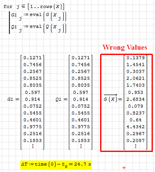

I have edited part of my original "SPI_Calc_Plain.sm" worksheet, and it
is evident the bug due to the vectorize operator.
Will come back soon with the edited version.
Thank you very much.

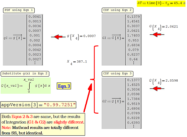

#18 Опубликовано: 12.11.2019 14:52:43
NDTM Amarasekera
NDTM Amarasekera
This confirms Jean's guess about vectorize operator.
TEST-SPI_Calc_Plain.sm (52,55 КиБ) скачан 1237 раз(а).
#19 Опубликовано: 12.11.2019 15:17:55
Answer is from observation(sss..)
My work sheet is clean and thus opened/calculated your 7251.
Your 7251 is corrupted and my 6179 executed the vectorize bug.
Mathematica has the expression shadow in context.
Read this: 6179 does not come with ZedGraph, one day some collab
posted a ZedGraph, 6179 did open and now my 6179 has ZedGraph.
SS 6346 had two versions: the official and un-official.
The un-official did lot more than the published version.
Detail about Gamma(x)like erf(x): under the integration operator,
they both need be vectorized. Maybe, the fact that I renamed/recast
it may have the virtue of doctoring. Though your Gamma(x) does
not play apparent role in the integration, it is still there as
a reluctant item to evaluate.
Now, if you recast your Gamma(x) Γ(x) in your original 7251
what happens bug/no_bug ? Like the English say: square the corner.
