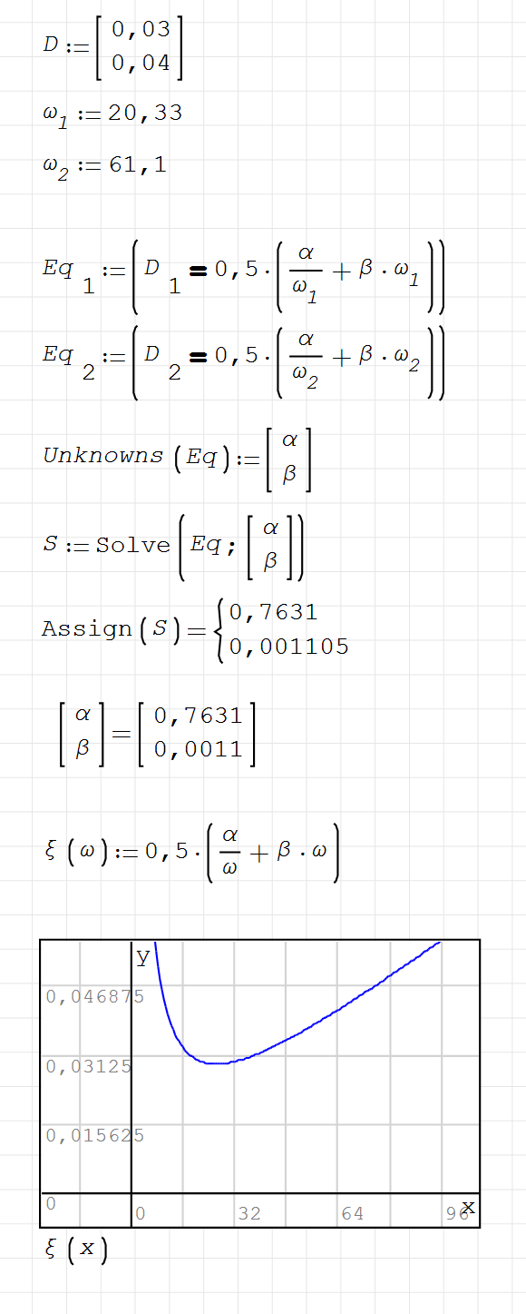

hi,
I used the Solve function a lot before but for some reason it does not work for this simple example.
I need to get the RayLeigh Damping factors alpha and beta using two frequencies, so two simple simultaneous equations should do it. tried using Solve but no luck.
Does anyone know why it is not solving?
Thanks in advance

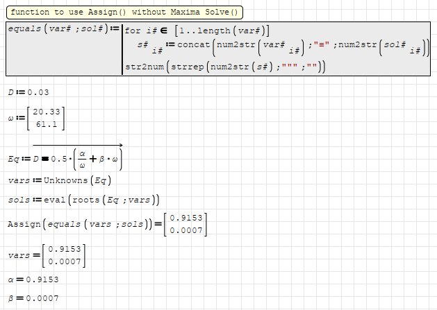

You can use roots() for your function. And a vectorize() can simplify it.
However, to use Assign() you will need this function to merge vars and solutions.
Assign_without_Maxima Solve().sm (7,36 КиБ) скачан 1128 раз(а).

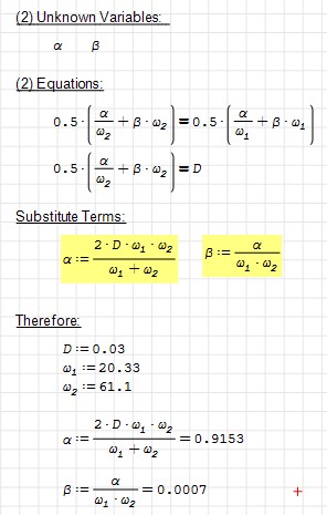

Greetings,
Another approach would be to use some elbow grease, you can substitute terms by hand and solve for 𝛼 and 𝛽:
Keypress (You can copy/paste the following into your worksheet):
α:{2*D*ω.1*ω.2}/{ω.1+ω.2}
β:α/{ω.1*ω.2}
*NOTE: ω.1 and ω.2 shown above are variables with subscript, they are not vectors ω[1 and ω[2; You should be able to substitute ω.1 for ω[1 if that serves your purposes.
- Kenny Lemens, P.E.

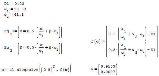

#6 Опубликовано: 06.04.2022 11:40:36
Fridel Selitsky
Fridel Selitsky
If the damping coefficients are denoted by α1 and α2, you can use the function al_nlegsoive
test.sm (6,99 КиБ) скачан 1147 раз(а).

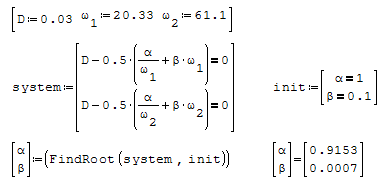

#8 Опубликовано: 07.04.2022 13:43:03
... more in there from native Smath code.
Solve FindRoot FORUM.sm (10,9 КиБ) скачан 1123 раз(а).

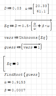

#10 Опубликовано: 07.04.2022 18:19:34
I think this is the most sophisticated method of my way.
It can get unknowns from equation, solve them.
In the end assigns numerical values to unknowns.
You don't need to define alpha or beta or any variable.
All process is automatic.
mathblock_v2.sm (5,19 КиБ) скачан 1127 раз(а).

#11 Опубликовано: 08.04.2022 02:19:42
Fridel Selitsky
Fridel Selitsky
There is also this way for guess define.
This is good, but for a system of linear equations(our case), the guess can be arbitrary.

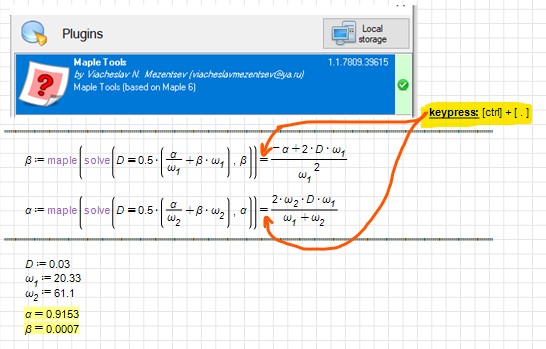

If plugins are considered, you can also consider the use of Maple:
In the image I posted, the 'equal sign' shown on those two equations are actually symbolic equals; keypress: [ctrl] + [.] instead of keypress [=].
Kenny Lemens, P.E.

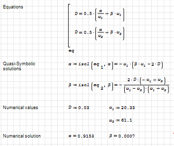

Hi. The isol solution, using only the Mathcad block plugin.
isol_example.sm (68,13 КиБ) скачан 1077 раз(а).
isol_example.pdf (34,57 КиБ) скачан 588 раз(а).
sergio 12.04.2022 05:01:00
