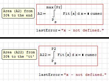

integrals aren't calculated in this example. Culprit is maxima plugin.
