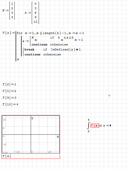

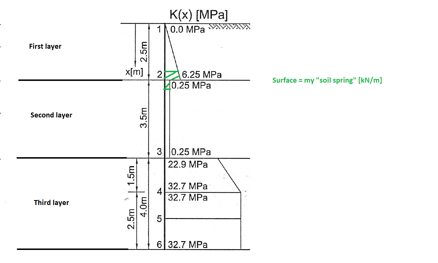

I'm trying to write a function that I can use to calculate the surface area. The function is to be based on data from a matrix with n elements
I ran out of ideas. I guess the problem is in a loop.
I attach a file and an image.
I will be grateful for your help.

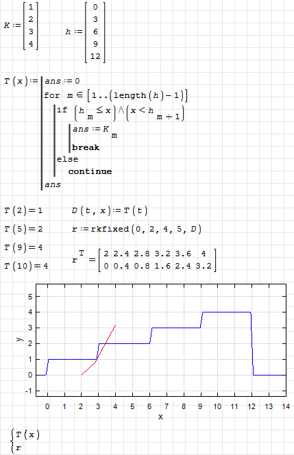

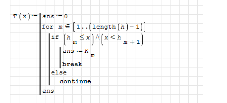

You can define piecewise function this way. Haven't figured out integration yet. Built in int() function doesn't seem to work.
Piecewise Function.sm (6,82 КиБ) скачан 1071 раз(а).

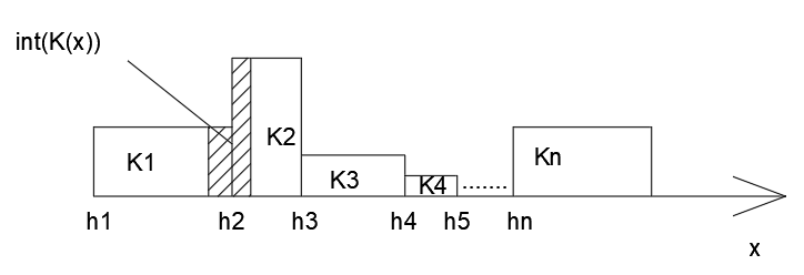

That was lavishly exemplified few hours ago.
Your drawing needs some project intention about,
i.e: what is what for what.

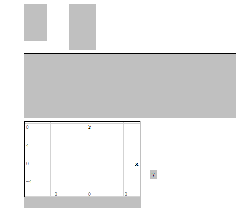

#4 Опубликовано: 20.09.2019 20:15:38
Latest version is all white. Could discover the blank regions,
framed the regions, added background.

#8 Опубликовано: 21.09.2019 04:37:10
XiuPer
XiuPer

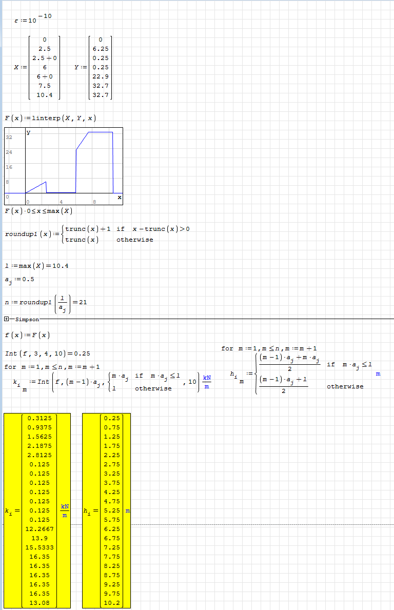

Thank you guys for your answers,
I will try to explain what I need.
Depending on the soil layers, I have a graph similar to the picture. At a later stage, I want to divide this chart into equal pieces (for example 0.25 m or 0.5m) to obtain "soil springs".
To simplify the example, I assumed that the elements of the K matrix are constant.
#9 Опубликовано: 21.09.2019 05:47:47

The idea of ​​using linterp is actually much better instead of a loop.
Below is the file with the result I needed.
Final springs.sm (20,64 КиБ) скачан 1094 раз(а).
