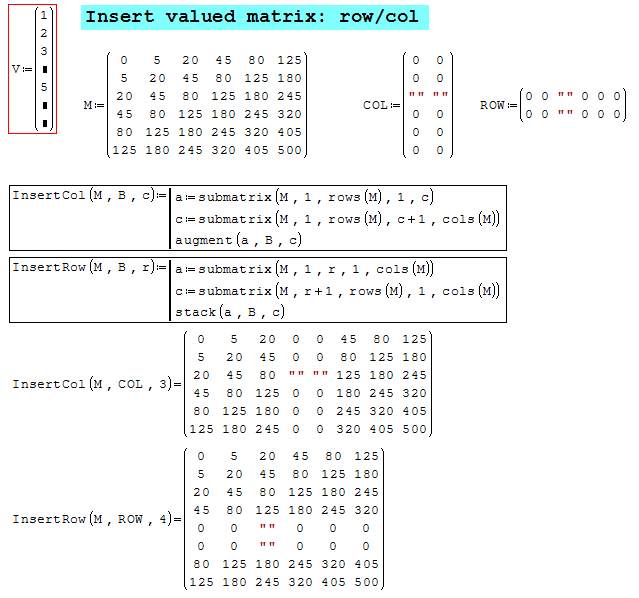

#5 Опубликовано: 07.06.2016 13:16:37
Thank you very much , but I can not add more lines correctly, it seems that separator is not active
In a single column vector, you can add place holder(s): type coma on the last
entered value. If you have too many : press Backspace. If you have constructed
an array [matrix], you need some tool to add/remove cols/rows. These tools are
available in the attached "Matrix Treasury".
Cheers, Jean
Utilities Matrix Treasury Copy.sm (285,74 КиБ) скачан 1084 раз(а).
This treasury was made in Smath older OFFicial release [April 2014] 5346.

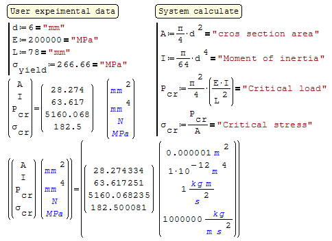

Ok here is the image, attention that in the below equations , I gave up making a system, I have just written down the 4 last equations ,only for the input data it worked well

Please notice that you cannot have results individually next to each subexpression in system: the system is one global expression that contains others, and only top-level expression's result may be displayed.
Also notice, that for systems (or matrices as well) of heterogenous elements, you cannot specify units, and even simple units (like Pa) will be displayed as their internal representation of base units of length, time, mass etc.
For homogenous structures, you may specify the common unit in the rightmost unit placeholder, as usual
One more thing: when posting screenshots displaying a question, it's generally a good idea to accompany it with an .sm file, so that others could avoid re-typing everything trying to reproduce.

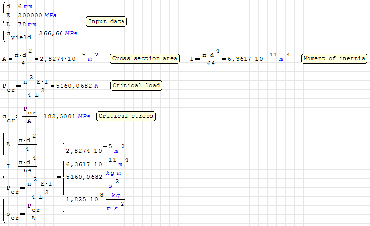

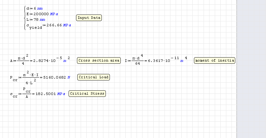

What else to complete a project ?

#10 Опубликовано: 08.06.2016 09:45:47
Thank you so much for your perfect answers
Welcome ... two typos expe"r"imental, cros"s"
