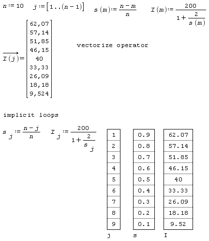

I am trying to to the following:
n:=[1..1200]
s(n):=(1200-n)/1200
I(n):200/(1+2/s(n))
"I get an error divisor matrix must be square"
any suggestions???
Vijay

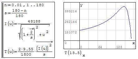

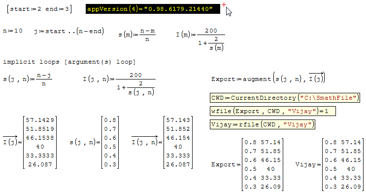

you divide by a vector. If you want to apply that by element, then use the vectorize operator.
Alternatively, you can use implicit loops.
In any case make sure that you don't divide by zero.
To upload images or files, use the paperclip button ("Insert an existing...." )
matrix2.sm (19,87 КиБ) скачан 1092 раз(а).

Too many parameters are missing to reproduce
r1, r2, E, x [u in Smath ... back to x in plot]

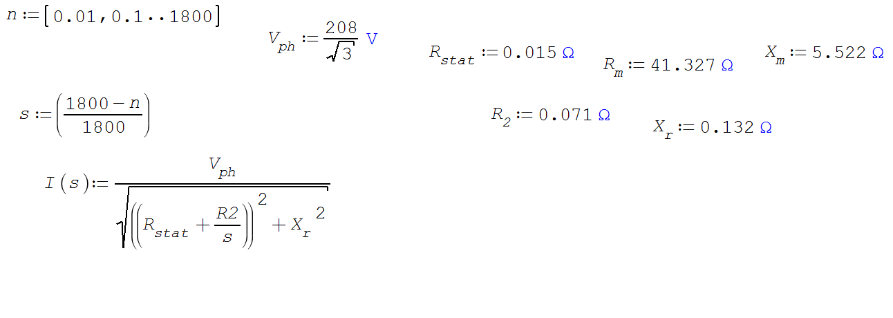

Thank you for your efforts, that's what I am looking for. I am resending the data with all the information. I have a few questions on your previous post, there is an arrow above 2/s and I(u)^2.What is that function. Also, you have used the value of u = 13.5? Also, when you plot the graph, did you just type T(13.5) to get the graph?
#10 Опубликовано: 16.03.2018 00:18:34
I am re-sending the data with all the information.
1. The arrow is the vectorising operator [same as Mathcad].
2. 'u' is the wild parameter of same nature as r1,r2
3. The system runs over 'n' taken into account wrt the vectorised arguments.
4. Shift@ to get the plot region, type T(13.5) then [ to get the index operator
then type x. The Smath plot argument is 'x'. So, by indexing, it will plot over
the running 'x'. If you want to plot ln(x), just type ln(x) in the plot place holder.

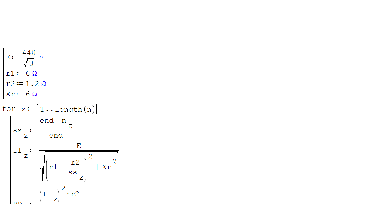

I will try to code your latest information, but busy next three days.
#11 Опубликовано: 16.03.2018 00:55:26
Now, you have another story [a different project].
Vijay(1).sm (26,88 КиБ) скачан 1103 раз(а).
#12 Опубликовано: 16.03.2018 07:46:41
starting from the basics, hope it might help you
example.sm (17,79 КиБ) скачан 1264 раз(а).

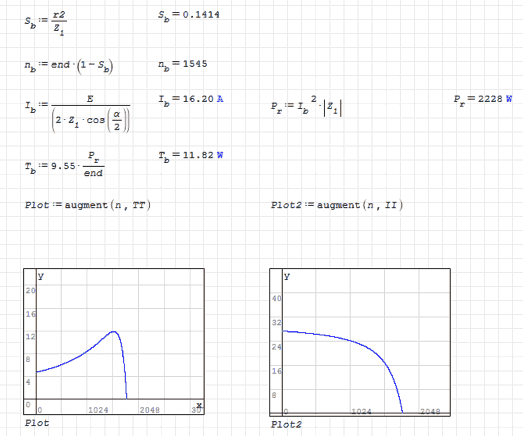

#15 Опубликовано: 16.03.2018 10:18:52
Back to original.
Vijay(1).sm (7,11 КиБ) скачан 1118 раз(а).

Attached is another similar file for which I have included the circuit diagram. I am assuming this will be posted in samples in this foroum.Файл не найден.Файл не найден.

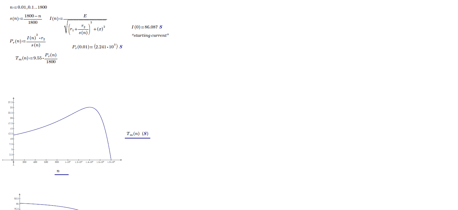

#18 Опубликовано: 16.03.2018 19:47:03
CBG
CBG
Something like this?
Vijay_CBG_Jean.sm (13,52 КиБ) скачан 1105 раз(а).

#20 Опубликовано: 16.03.2018 21:05:16
vijaykhatri
vijaykhatri
1 сообщений из 23 понравились пользователям.
Carlos
Thank you Carlos, just one question, how did you create the vertical line with multiple entries.
