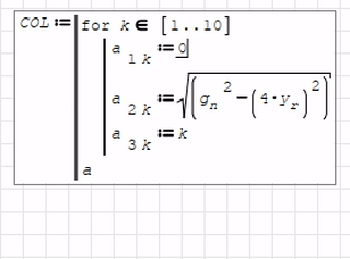

hi can anybody please explain why the following does not work, and how I need to change it.............
many thanks
#2 Опубликовано: 24.05.2021 19:19:39
many thanks
No problem here. You have misspelled the function.
The equality for 3*4 or 4*k is next to matrix element.
It has to be next to matrix, whole of it.
COL_FOR.sm (4,49 КиБ) скачан 1196 раз(а).
#3 Опубликовано: 24.05.2021 19:58:27
Jim
Jim
Thank you "overlord"..............what a basic error, I feel stupid, must need new spectacles. hehe.
#4 Опубликовано: 24.05.2021 22:23:47
No need to be. Everybody make mistake, especially if it is simple.
Feel free to ask questions. Someone shall reply, be sure of it.
#5 Опубликовано: 25.05.2021 18:34:37
Your coding is wrong for your application,
but correct for other application(s) ... StripX(data).

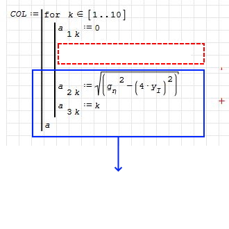

Folks, I have another query please and am grateful for help.
As per diagram below, how do I move several lines down and create space for another equation inside my "for" loop.
#7 Опубликовано: 25.05.2021 20:22:23

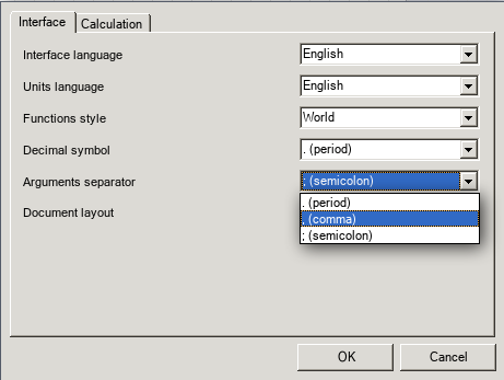

Use your arguments separator for this.
This works also for vectors but not for matrices.
#8 Опубликовано: 25.05.2021 20:57:18
#9 Опубликовано: 25.05.2021 21:08:54
Jim
Jim
thank you, but can you please clarify what exactly is the "arguments separator" ?
#10 Опубликовано: 25.05.2021 21:12:44
It depends on your setting.
Its setting is under Tools > Options.
I use semicolon, default is comma I guess.

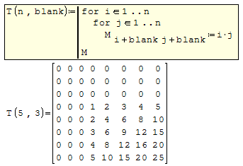

#11 Опубликовано: 25.05.2021 21:22:37
how do I move several lines/cols down/right and create space
#12 Опубликовано: 25.05.2021 21:33:27
Page12 Ravel Matrix.sm (9,46 КиБ) скачан 1292 раз(а).

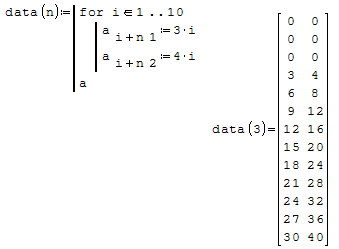

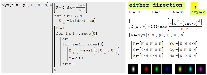

#13 Опубликовано: 26.05.2021 17:59:38
26 сообщений из 155 понравились пользователям.
This is like Schrodinger's answer, both right and wrong at the same time, lol.
#14 Опубликовано: 26.05.2021 20:07:15
I greatly admire that you have recognized
the long functional romance was Shrodinger lol !
Otherwise coded from Mathcad ODEsolve .
Maths Schrodinger.sm (67,54 КиБ) скачан 1098 раз(а).
