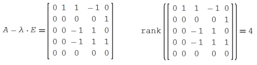

Hallo zusammen,
DimEigenraum: (n-rank(A-λ*E))=1@#
should be 2
some steps of elementary row additions later
is 2
https://de.smath.com/cloud/sheet/vooDFR4FbP
any idea whats wrong?

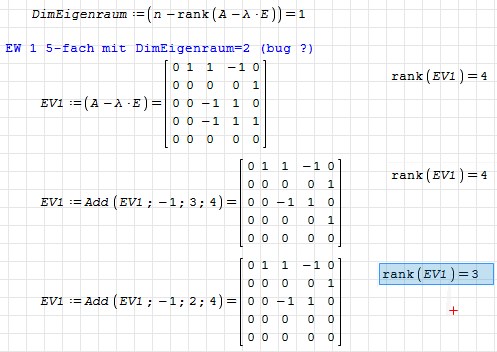

and in how far do your example explain the incorrect calculation
The referenced sheet seems to use Maxima(). This doesn't work, as third party plug-ins aren't available in the cloud version.
It is better to attach such files here.
the Maxima part calculate the single eigenvalue which is set manually in cloud version
SMath Studio 0.99.6884 - [JordanMatrix5x5-5fachEW-HV.1.2.Stufe.sm_]_2020-04-19_19-07-08.jpg
JordanMatrix5x5-5fachEW-HV.1.2.Stufe .sm (47,19 КиБ) скачан 1114 раз(а).

Hi. You're right, it's a bug and there are no way to make this works (numerical nor symbolic):
First column is zero and 3th = - 4th columns, so can't be rank = 4.

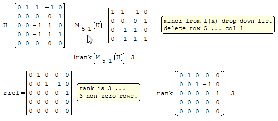

Just advanced maths above the classroom.
Your example replies bug from incorrectly threaded input.
As given, your [5*5] matrix has no mathematical meaning.
Page1 rank.sm (11,74 КиБ) скачан 1279 раз(а).
