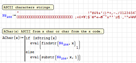

There is another brute force option for character to unicode number - findstr().
The benefit of the approach is that once the search target is built, the search is reasonable fast (0.015 s), you only see it when the calculation runs without problems.
BTW, don't try to display S, this produces a soft crash in both versions.
Also, hovering over the definition of S produces a soft crash, due to the attempt to preview the contents.
uchar.sm (20,72 КиБ) скачан 1156 раз(а).

WroteThere is another brute force option for character to unicode number - findstr(). ...
Hi Martin. That's the technique adopted for this function here.
Unfortunately N.256 requires some adjustment as it cannot properly save the characters less than 32.
However, I think that a function like uchar could be much more practical and stable in a C# plugin, perhaps in SpecialFunctions or some other similar.
