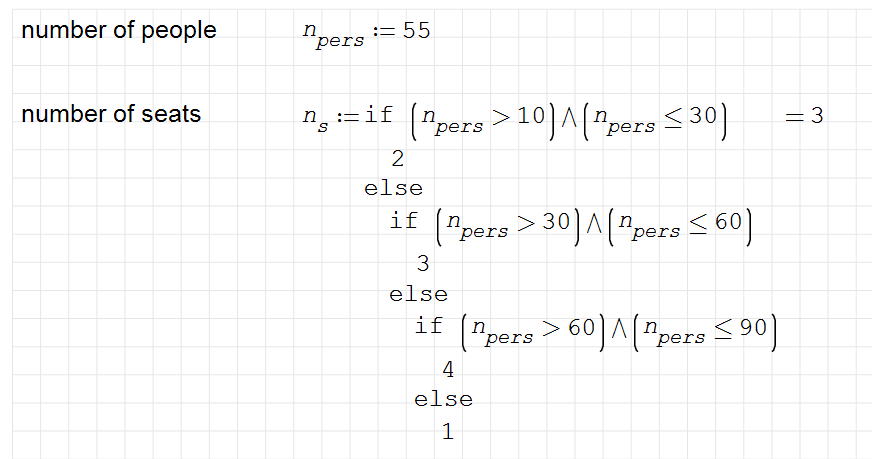

Hi to everyone, I'm a new user of S-math.
I'm a newbie to programming.
Today I had to make a calculation to size the number of seats in a waiting room according to the total number of people.
The number of seats must be 1 for every 30 people.
I tried to make the calculation automatic via S-math, but I was unable. I thought the for loop might help me, but I don't know how. Can someone help me?

Hi I try to explain better what I want to calculate.
I would like to set up a for loop that allows me to do the same calculations as the if loop in the figure.
for example
if n.pers < 10 ---> n.s = 1
if n.pers > 10 & n.pers < 30 ---> n.s = 2
if n.pers > 30 & n.pers < 60 ---> n.s = 3
if n.pers > 60 & n.pers < 90 ---> n.s = 4
and so on
I don't know how if it's possible set up this cycle, anyway thanks.

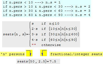

Hi
I'm probably doing something wrong because, for exemple, with 40 or 70 it doesn't work.
#7 Опубликовано: 12.10.2021 14:38:28
Hi
Probably, please use the file below.

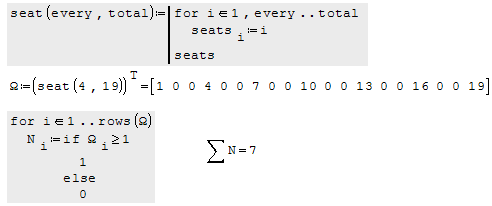

#12 Опубликовано: 12.10.2021 20:25:44
You can elongate at will:
1. collect the last condition from RHS
2. double coma
