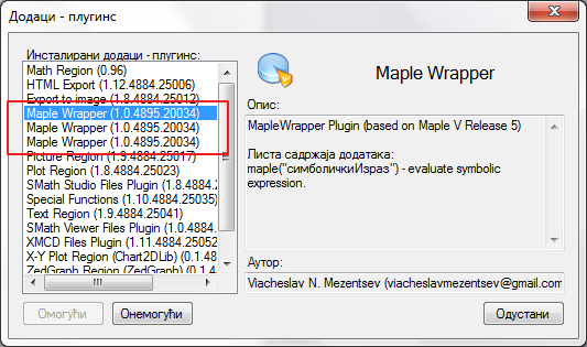

#6 Опубликовано: 27.05.2013 08:21:35
Try MapleWrapper. Doesn't work saving regions. No assembly for MaplePlot and Maple.
Result for Maple Plot (RegionHolder):
f4417ad2-3313-4b10-bcaf-96ac84d9c57d
2
4
5
decimal
&[DATE] &[TIME] - &[FILENAME]
Result for Maple (RegionEvaluable):
3
4
5
decimal
It doesn't have a placeholder but the tag is present.
[albumimg]183[/albumimg]
