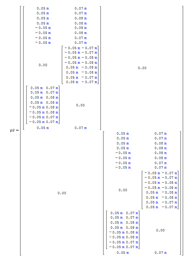

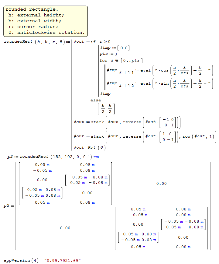

Hi Davide, and thanks for this wonderful sheet.
I found a bug in the sheet, for some reason all the rectangle solid or hollow sections don't work. I am using build 7822.
I tried to test your code and for some reason, the compounded matrix created from your shape functions does not end up being a matrix with "n" rows and "2" columns but rather a matrix in a matrix and I don't know why

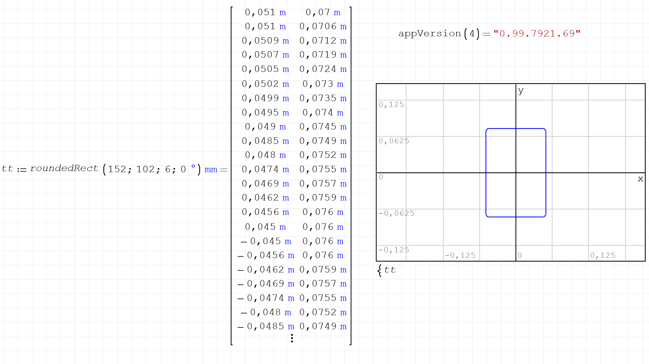

Thanks Pompelmo, I updated my Smath and still the problem exists!!
Itried to uninstall all Smath and reinstall it again with the same problem!!

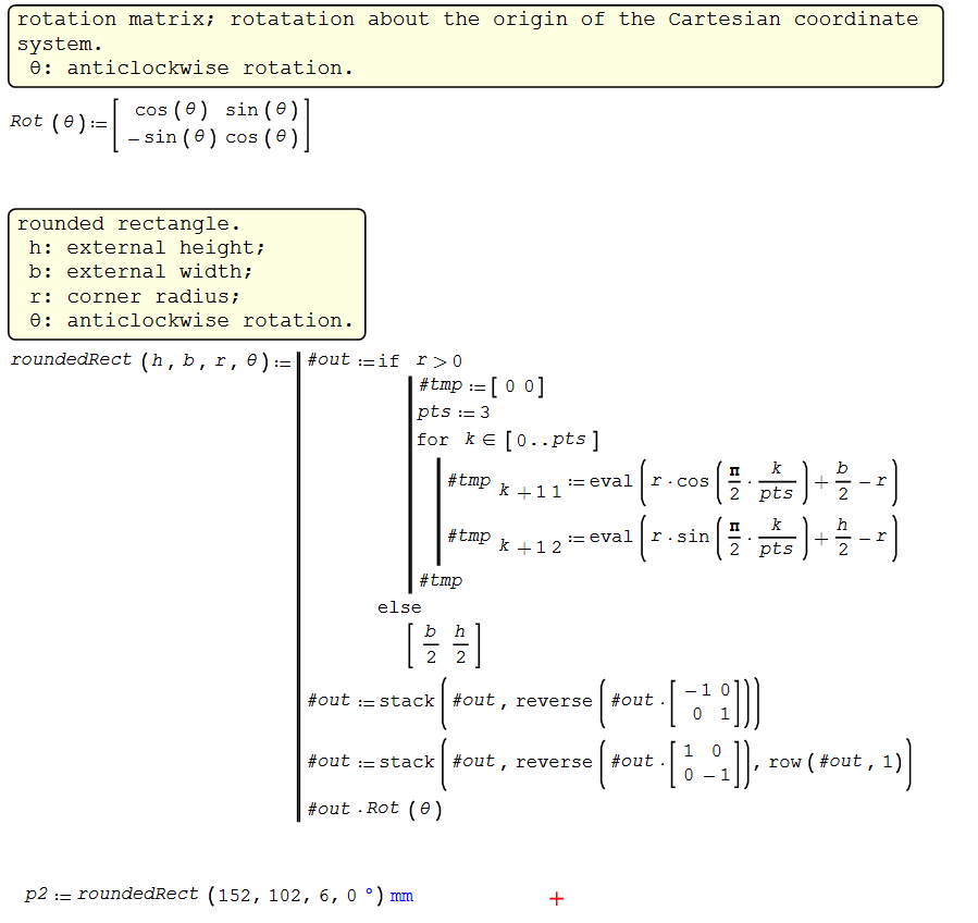

#28 Опубликовано: 10.01.2022 14:26:23
Just change p2:roundedRect(...) optimization from symolic to numeric.

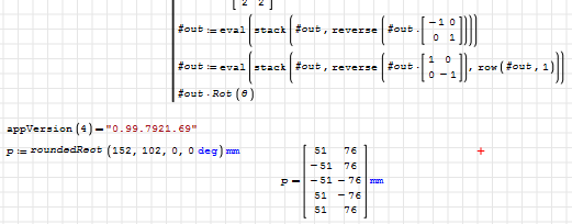

#29 Опубликовано: 10.01.2022 17:39:14
In my personal experience, the stack and agument functions, along with other allies such as reverse and matrix, always manage to cause some kind of issue. The issue also is related about where the evaluation appear, or the function, or something else. The attached shows the issue in an isolated environment.
roundedRect.pdf (124,42 КиБ) скачан 834 раз(а).
roundedRect.sm (24,85 КиБ) скачан 1438 раз(а).
With those two evals it seems that roundedRect works, for numeric and symbolic evaluations.
Mo 10.01.2022 18:24:00
#30 Опубликовано: 10.01.2022 18:25:39
Mo
Mo
0 сообщений из 34 понравились пользователям.
THANK YOU, Davide !!!, THANK YOU, Razonar!!!
