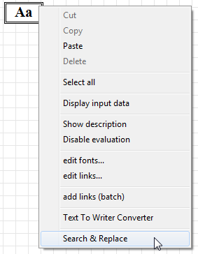

Also, I'm not able to find Search and Replace Toolbox.
There's not a dedicated toolbox, both the new features are in the context menu of the TextRegionUtilities toolbox.

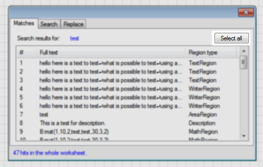

* to have a checkbox to see all findings as selected; this would allow a better global look.
That's a nice idea, I'll see what I can do. DELIVERED

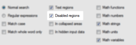

* to search also in the disabled regions (it seems that as now, only the active regions are examined); eventually by checking a box.
This option already exists, doesn't work?

1. It's fine. The "Select all" button operate. It selects the whole regions where the search match.
I'm not sure, but I think it woud be preferable to keep the selection of only matched name as for individual name, but to get them all.
The "multiple selection" is available only when a single region is focused, and only for MathRegions (the grey selection you can see using F8).

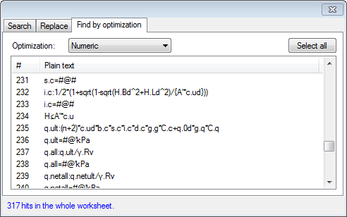

#28 Опубликовано: 11.02.2016 20:51:31
PLUGIN UPDATED
- Search & Replace: added new tab "Find by optimization";

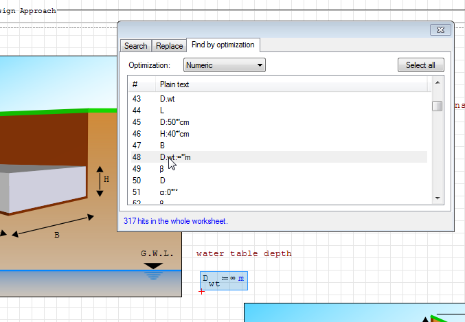

Not exactly, the "Find by optimization" tool scan the math regions in worksheet looking for the choosen optimization.
If you click on a single result, the worksheet scrolls to that region and select it
2016-02-12 09_11_55-SMath Studio Desktop - [Bearing Capacity_2013.00.01.sm_].png

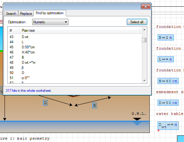

If you click on the "select all" button, all the found regions are selected
2016-02-12 09_13_44-SMath Studio Desktop - [Bearing Capacity_2013.00.01.sm_].png

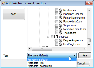

#31 Опубликовано: 12.02.2016 12:03:35
PLUGIN UPDATED SMath Studio 0.97.5346 and SMath Studio 0.97.5737
- Latest plugin tools made available for SMath Studio 0.97.5346;
sergio 12.02.2016 14:46:00
#32 Опубликовано: 15.02.2016 15:05:07
PLUGIN UPDATED
How about using the Document title property from the file header as (possibly multilingual) text in the link regions?
Done. Metadata title or description can be used as text of the hyperlinks (on *.sm files, if available, otherwise the filename is used)

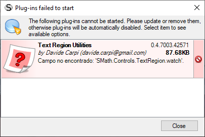

I seem not to be able to install the TextRegionUtilities plug-in with the latest version of Smath Studio. I get the following message when I try to install the plug-in:
Field not found: 'Smath.Controls.TextRegion.watch'.
appVersion(4)="0.99.7045.23606"
Windows 7
Thanks in advance for any help.
#38 Опубликовано: 24.04.2019 10:23:31
Farja
Farja
1 сообщений из 7 понравились пользователям.
With the last version of Smath (0.99.7053.26276), the error is still present.
#39 Опубликовано: 25.04.2019 06:36:59
Thank you, confirmed. That property in the API is no more available, I'll check what can be done.
