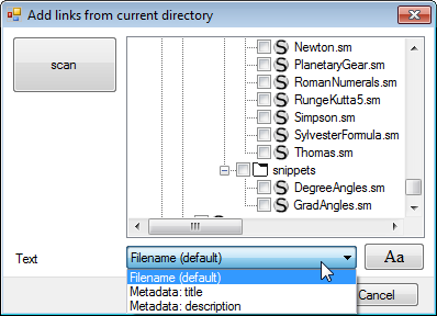

How about using the Document title property from the file header as (possibly multilingual) text in the link regions?
Good idea, I'll explore it.

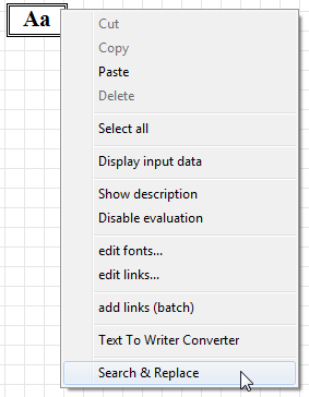

Also, I'm not able to find Search and Replace Toolbox.
There's not a dedicated toolbox, both the new features are in the context menu of the TextRegionUtilities toolbox.

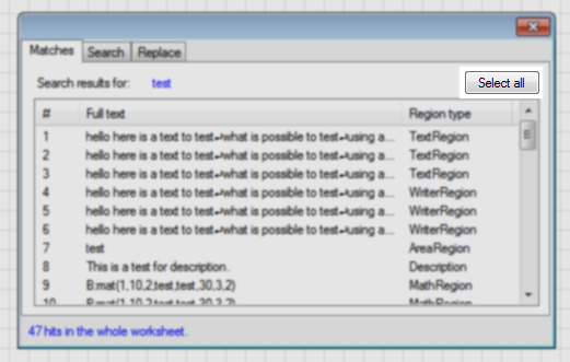

* to have a checkbox to see all findings as selected; this would allow a better global look.
That's a nice idea, I'll see what I can do. DELIVERED

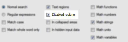

* to search also in the disabled regions (it seems that as now, only the active regions are examined); eventually by checking a box.
This option already exists, doesn't work?

1. It's fine. The "Select all" button operate. It selects the whole regions where the search match.
I'm not sure, but I think it woud be preferable to keep the selection of only matched name as for individual name, but to get them all.
The "multiple selection" is available only when a single region is focused, and only for MathRegions (the grey selection you can see using F8).

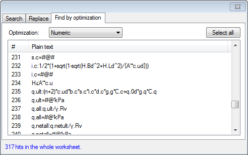

#28 Posted: 2/11/2016 8:51:31 PM
PLUGIN UPDATED

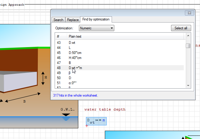

- Search & Replace: added new tab "Find by optimization";
ioan92 2/12/2016 5:12:00 AM

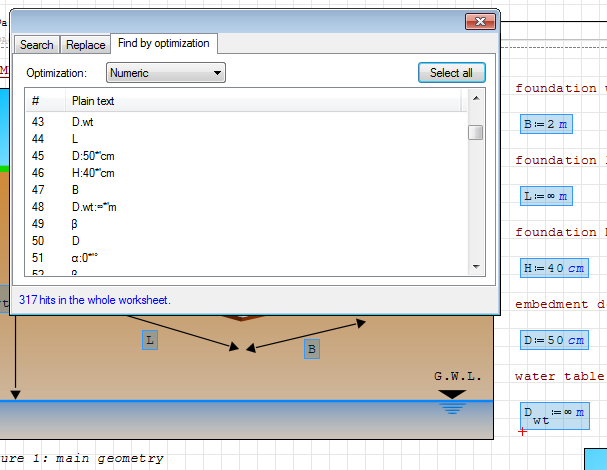

Hello Jean
Not exactly, the "Find by optimization" tool scan the math regions in worksheet looking for the choosen optimization.
If you click on a single result, the worksheet scrolls to that region and select it
2016-02-12 09_11_55-SMath Studio Desktop - [Bearing Capacity_2013.00.01.sm_].png
If you click on the "select all" button, all the found regions are selected
2016-02-12 09_13_44-SMath Studio Desktop - [Bearing Capacity_2013.00.01.sm_].png
Any further action on the optimization can be done on the canvas (right click > optimization)
Obviously you don't need this if you want a worksheet with an omogenous optimization (CTRL+A -> context menu on a math region -> optimization), however a sanity check is always good practice.
As principle it is possible to do the same from the tool (if it is useful, needs just some code and a reorganization of the GUI)
BTW I've tried to build the recent updates also for SMath Studio 5346 but I get some errors, I have to check them.

#32 Posted: 2/15/2016 3:05:07 PM
PLUGIN UPDATED
Done. Metadata title or description can be used as text of the hyperlinks (on *.sm files, if available, otherwise the filename is used)

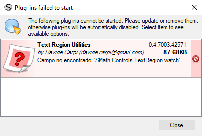

I seem not to be able to install the TextRegionUtilities plug-in with the latest version of Smath Studio. I get the following message when I try to install the plug-in:
Field not found: 'Smath.Controls.TextRegion.watch'.
appVersion(4)="0.99.7045.23606"
Windows 7
Thanks in advance for any help.
#38 Posted: 4/24/2019 10:23:31 AM
Farja
Farja
1 likes in 7 posts.
With the last version of Smath (0.99.7053.26276), the error is still present.
#39 Posted: 4/25/2019 6:36:59 AM
Thank you, confirmed. That property in the API is no more available, I'll check what can be done.
