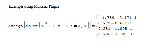

Here an example solved by using Maxima plugin:
best,
Oscar

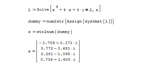

How to put these answers of Maxima plugin inside a vector?

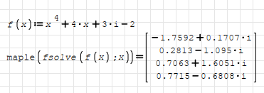

You can use maple() too.
Maple has a fsolve() function.
Which uses floating-point arithmetic.
A little trikiest
ioan92 18.11.2023 21:05:00, Oichi 18.11.2023 21:23:00

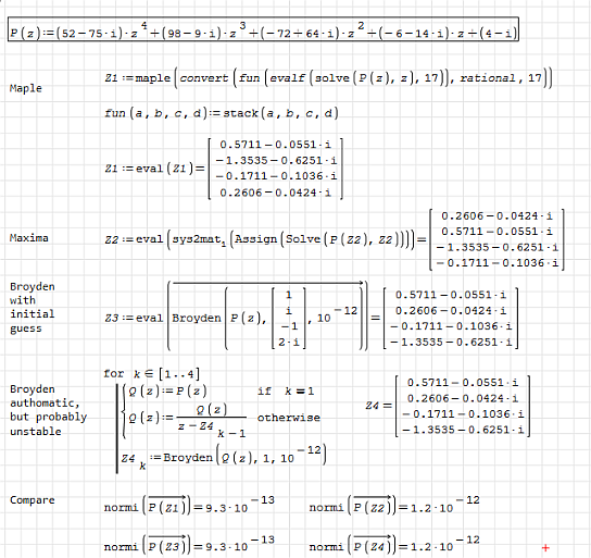

Hi. Another way.
zroots.sm (19,36 КиБ) скачан 779 раз(а).
