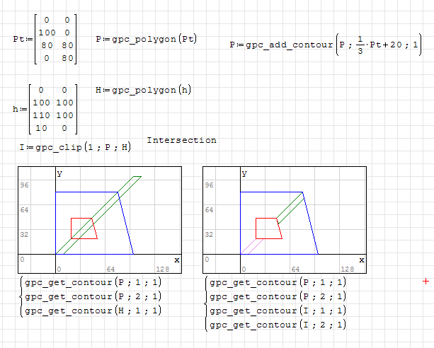

I'm looking for suggestions to find the intersection of two polygons and hatch the result.
The most particular case concerns the hatching of a part of polygon intersected by a straight line.

Perhaps the GPC (general polygon clipping library) wrapper plugin might help. The basics are described in section G.3 of the german handbook.
You also might have a look at the hatch and fill snippet.
GPC.sm (6,8 КиБ) скачан 1819 раз(а).

Otherwise, piece wise from native Smath ... just demo.
Circular Polygon.sm (20,93 КиБ) скачан 1163 раз(а).

Hi. Maybe you also can check this discussion: https://en.smath.com/forum/yaf_postst11405_Line-intersections.aspx
