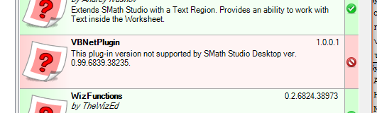

#4 Опубликовано: 27.10.2018 23:00:16
Basile
Basile
Davide,
This is what I have: It still persists every time I start SMATH.

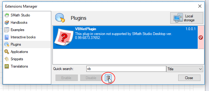

#5 Опубликовано: 28.10.2018 06:01:34
you can simply remove it.
#6 Опубликовано: 28.10.2018 12:07:17
Fixed, plugin recompiled. The plugin version was tied to a fixed value "1.0.0.1" that was causing issues on update logic.
