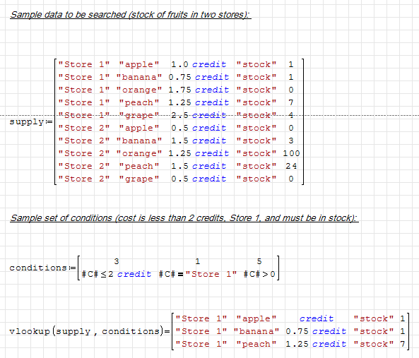

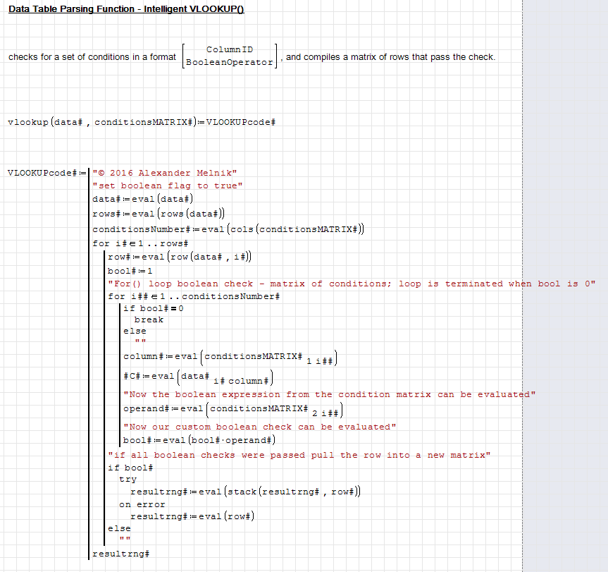

I would like to share an example of function that extracts rows from a data table based on set value in selected columns:
VLOOKUPdataparse.sm (17,57 КиБ) скачан 1194 раз(а).

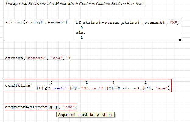

I do need help with an interesting behaviour of a matrix definition:
If an element of a defined matrix contains a user defined function with an undefined parameter it may inthrow an error similar to here (same SMath file as above):
I would expect the function with undefined parameter to return itself instead of giving an error code.

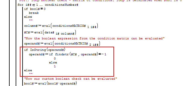

I think the issue comes out because there isn't a way to stop the preprocessing in user-defined functions when you pass an unknown (and an unknown is not a valid input).
A workaround that might be useful even to avoid the use of other functions is to use a string as input in the second row, and a check in your lookup like this:

Is the a reason why function like findstr() does not return itself when not all variables are defined? Similar to this:
http://en.smath.info/forum/yaf_postsm36158_cases-in-definition-of-a-function.aspx#post36158
Also I am not sure if this is similar, but after I modified my excel_IO() function to return FALSE if undefined variables were present it would preprocess correctly with undefined variables when passed as an argument to a user defined function (you and I had an email discussion about this).
P.S.: the reason why a more general solution is desired is because a one might want to implement a more complex boolean check, than <>=!
#5 Опубликовано: 03.01.2017 12:37:22
It is by design. However even returning itself, you will have always var=findstr(...) -> false -> ... (it doesn't prevents the strcont() function to be evaluated)
Yes, but with functions created on the canvas this isn't possible

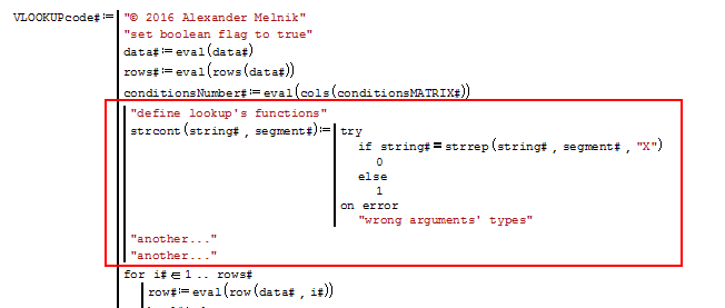

You can try with this:
strcont() is defined locally to avoid the preprocessing on the canvas
try() function is added because when you use el(...) inside the lookup function, all the elements of the condition matrix are evaluated -> you have to allow any type of input as first argument or let it fails silently (because strrep requires strings); note that if the selected element of the condition matrix is the one that contains strcon() with a wrong type as first argument, the error string will trigger an error on bool#:eval(bool#*operand#), because operand# will be a string.
Alexander O. Melnik 03.01.2017 12:41:00, frapuano 03.01.2017 14:55:00
