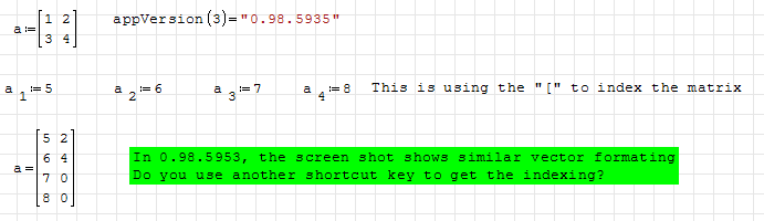

Not sure about the different syntax for linear indexing.
Does the "[" do something different?
#3 Опубликовано: 20.04.2016 11:49:16
Hello.
Not sure I understood your question.
Linear indexing for matrix was buggy in previous versions. In latest one it is finally fixed. Please see http://smath.info/bts/Issues/IssueDetail.aspx?id=129 for details.
P.S.: Yes, I've used "[".

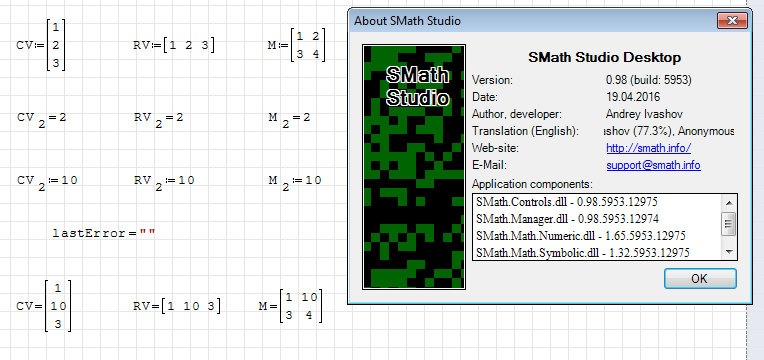

  • Added ability to assign variables/functions put into the vector/matrix;
  • Nice feature

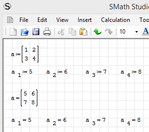

    if possible I suggest to improve the error message when the LHS doesn't fit the RHS (something like "wrong assignment pattern")

    Andrey,
    a[1 and a[2 do not need the "j" variable. In your screen shot, a[3=a[1,2 in my file and a[4=a[2,2
    I've attached my fileIndex.sm (8,35 КиБ) скачан 1588 раз(а).
    I understand nothing in here. You can create matrix as you wish [Smath 5346]

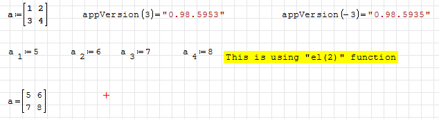

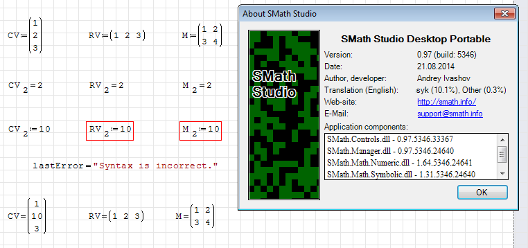

    Linear indexing is a feature to identify an element of a matrix using a single number (base 1 index, starting from the top-left element, proceeding by columns and then by rows]
    [1 2 3 4]
    [5 6 7 8]
    [9 .....]
    Previously it was possible to use el(2) (one-index element) on matrices only in these cases:
    - to set elements in column vectors:
    - to get elements of column vectors;
    - to get elements of row vectors:
    - to get elements of matrices;
    Assigning elements in matrices or row vectors wasn't possible:
    In the meanwhile, a bug was introduced and it was possible to use el(2) in the LHS of assignments for any matrix, but in a wrong way.
    Now it is possible to use this feature to get and set elements of any matrix:
    Andrey Ivashov 20.04.2016 18:35:00
    So its the el(2) function!
    Not sure about the different syntax for linear indexing.Does the "[" do something different?
    That is why I was asking if Andrey was using "[" to define the matrix. I may have a use for the indexing which is why I was asking.

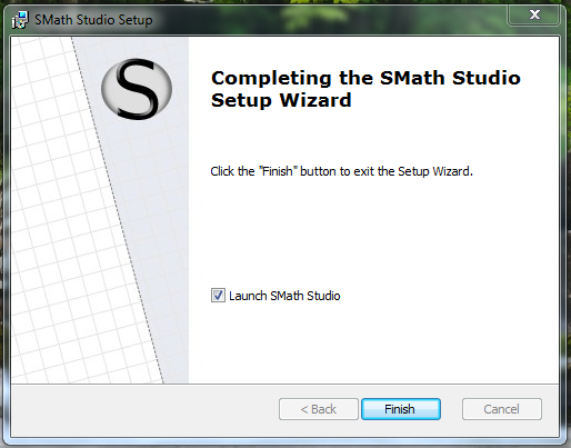

    I have had an install problem with the 0.98.xxxx series versions, installer locks up. I need to go into task manager and kill the install screen after updating or installing fresh at this window.
    If I put my mouse over this box, in Windows 7 (32 and 64), I get the mouse cursor to go to an spinning wheel. Program works fine in all installs otherwise.

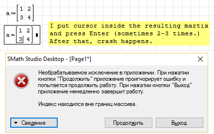

    OK, seriously, I'm really excited with this recent progress, and my constant flow of bug reports isn't meant to discourage Andrey; to the contrary, I wish this projest to prosper and flourish, and to be as problem-free as possible.
    Andrey, thank you for this new build and for all your work!
    EDIT: Oh, I feel so stupid! I wrote "Enter", while I must had written "Arguments delimiter (mine is semicolon)".

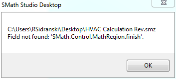

    Mike, I cannot reproduce. I just updated on of my machines to this build. I go into the resulting matrix and the red cross bar "kicks out" into white space. However, on another existing file that was working correctly, it won't open

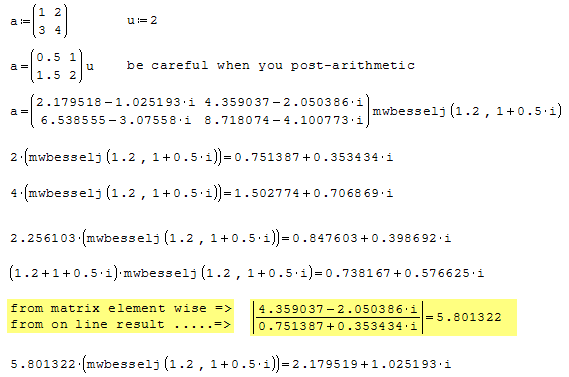

    Hello Collabs,
    From a matrix result, you can do 3 things immediately besides
    conventional matrix algebra [rotation, transpose, rotation, inverse ...]
    1. drag/select, copy/paste element
    2. extract indexed element
    3. post process [arithmetic, function]
    Be careful on [3] versus other CAS [Matlab, Mathcad ...]

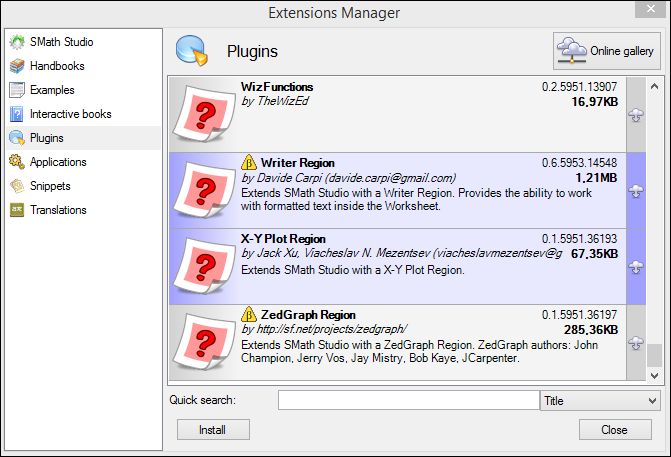

    You need to open Plugins tab in Extensions Manager, switch to Online Gallery and find & install all available updates there. After SMath Studio restart you will not see this error anymore.
    I'm working on the wizard which will assist users to do this semi-automatically on every SMath Studio update as it is the most common issue now.
    Davide Carpi 20.04.2016 19:06:00, Mike Kaganski 20.04.2016 20:59:00

    ... switch to Online Gallery and find & install all available updates there.
    I forgot to switch to online

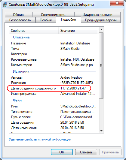

    Why is the content creation date in MSI is shown 11/12/2009?
    Actually, I needed this information when I noticed that this release was released twice: I have been notified by update manager and updated promptly, and haven't been notified again after that, but I started to see files that are "created with a newer SMath version" - 0.98.5953 (the same as mine), but last (fourth) part of version was greater.
    С уважением, Михаил Каганский

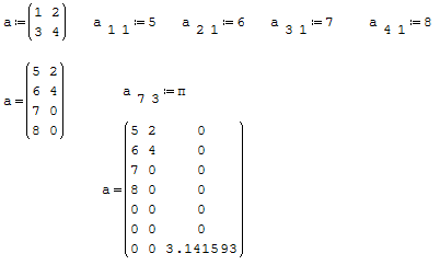

    Spotted matrix definition bug if using Clear():
    Also nested definition is not supported? In a form of
    el(el(M,1,1),1,1):5
