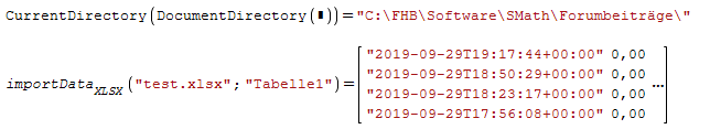

As was already mentioned, you can import to xlsx using excel with comma as column delimiter and then import to SMath Studio.
BTW, there is a glitch in mouse handling of the matrix resizer. It seems to compute the mouse drag required for resizing based on width of the first column.
importtest.sm (3,26 КиБ) скачан 1147 раз(а).
test.xlsx (11,49 КиБ) скачан 766 раз(а).
