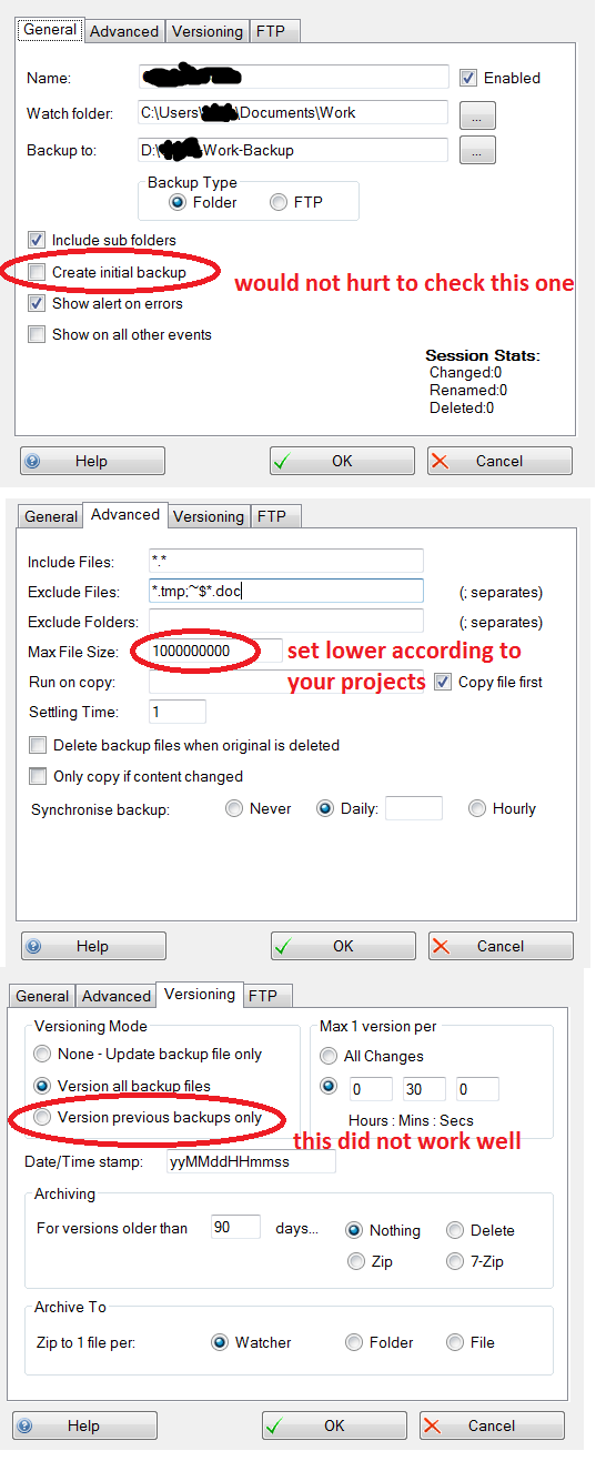

Figured I should share this with the community.
How often does it happen to you that the file you are working on needs to be restored to an earlier version? For any reason.
If often, one particular solution that works is using AutoVer in conjuction with, say 1TB hard drive. This little software will create versions of file for you when you modified, up to a certain maximum per hour.
http://beanland.net.au/AutoVer/
Here is a set of starting settings that work for me:
