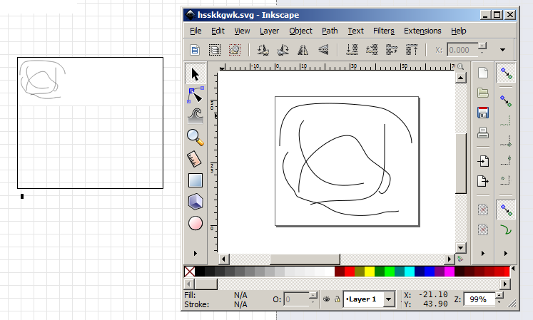

Hi All,
My 4th revision of the plugin.
On region cloning (ctrl is pressed) region is duplicated with new filename
On region copy / paste region is copied however filename does not have an extension (have no clue why, code is attached if you decide to dig around). Fix - right click and select desired extension
SVG does scale, however not in a way I would like it to (like a raster image)
If you have time please test - must catch bugs before sending it to repository
ImageRegion.004.zip (290,76 КиБ) скачан 444 раз(а).
Major deficiency - on re-opening the workbook file names loose its extensions. I'm sure its set to happen so in the code - I just need to find where/how does the region store its filename.
Also will likely have to leave svg non scalable for now - raster scaling is just plain wrong.

Plugin build updates:
1. On region copy / paste region is copied however filename does not have an extension & on re-opening the workbook file names loose its extensions. - FIXED
2. Now copy / paste generates region with same name, while ctrl drag generates region with new name
3. Image boundaries in the region and in inkscape don't match. There is spurious whitespace to the right. - FIXED
4. Newly created .svg file now scales correctly after being edited in inkscape.
5. when the region is empty, the border does not indicate on/off state (yet the setting seems to be stored, image content seems to be required for the border to show up correctly - Cannot Reproduce, pls attach .sm workbook and explain what is wrong.
Side note - Martin, should I create a separate thread so this thread does not fill up with my frequent build updates?
ImageRegion.005.zip (271,01 КиБ) скачан 405 раз(а).

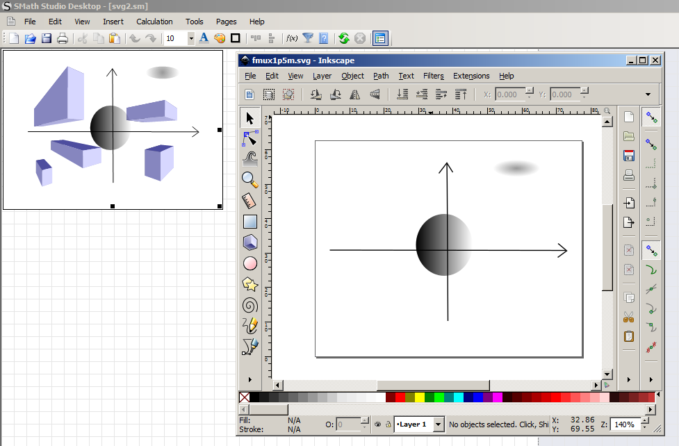

Another problem:
If I open the image in the attached sm file, then some objects are invisible in inkscape. They all were created with inkscape. The reference points of the 3D projection seem to get lost or modified. Could that be a side effect of the size handling?
svg2.sm (28 КиБ) скачан 1356 раз(а).
