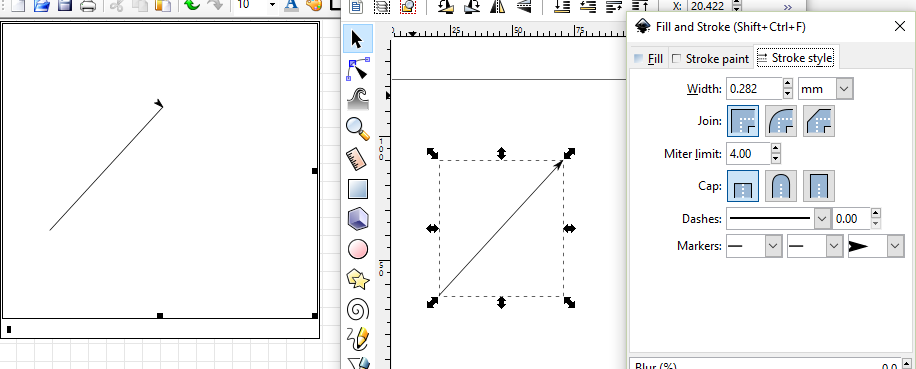

I am not sure if this counts as major grief, but here is screenshot where displayed stroke style is different from what was intended in inksape.
#63 Опубликовано: 04.02.2016 00:54:57
____________________ certainly very annoying:
... missing closure in Inkscape ? ... problem saving from Inkscape ?
... Smath not reading correct ? [doubtful]

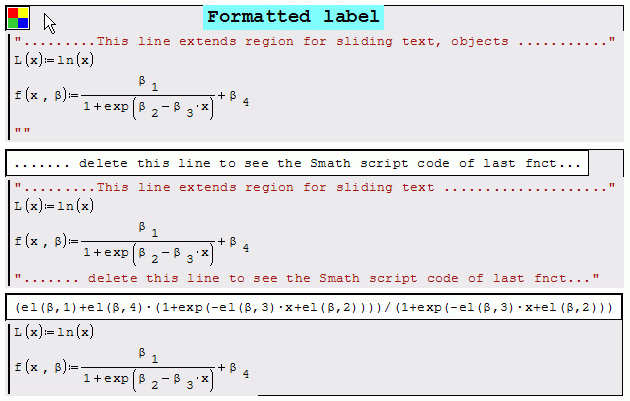

The last brick in the wall about editable region(s) is the "Formatted Label".
Possibly useful for collecting functions of same family, vg: PDF, CDF ...

1. Rendering of inkscape arrows. Even though I am using new SVG renderer, the arrow is still off - now it is reversed. On a plus side - arrow on the left end of line points correctly - use that one.

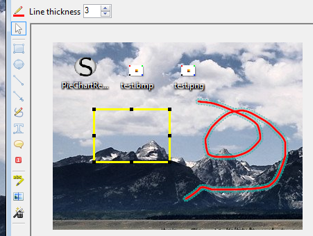

I need .psd to simplify stetching on top of existing blueprints / drawings - one layer - existing drawing, another - my freehand stuff.
Not sure if this is easier but I think a good approach may be to replicate what is possible to do with the image editor of greenshot. Any sketch may be treated as an object of the region (like a layer) drawn over the background. Part of the code may be taken from the modeller region. Just an idea.
EDIT
Keep in mind that re-rendering of SVG only on click or evaluation is not a bug - it speeds up resizing
You can define a private bool Resizing -> OnMouseDown: set it true if you are over the resize markers -> OnMouseUp: if is true trigger the re-rendering and set it to false;
