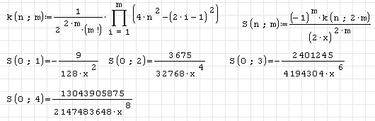

(see attachment). It is working very well so far, but now I want to increase the precision a liitle bit by adding one or 2 summands to his P and Q polynoms (see attachment) But unfortunately I don't fully understand his notation form not even though he is describing it. (sse attachment)
Is there anybody who could help me with that?

Try this. I just literally defined the functions and it seems to work.

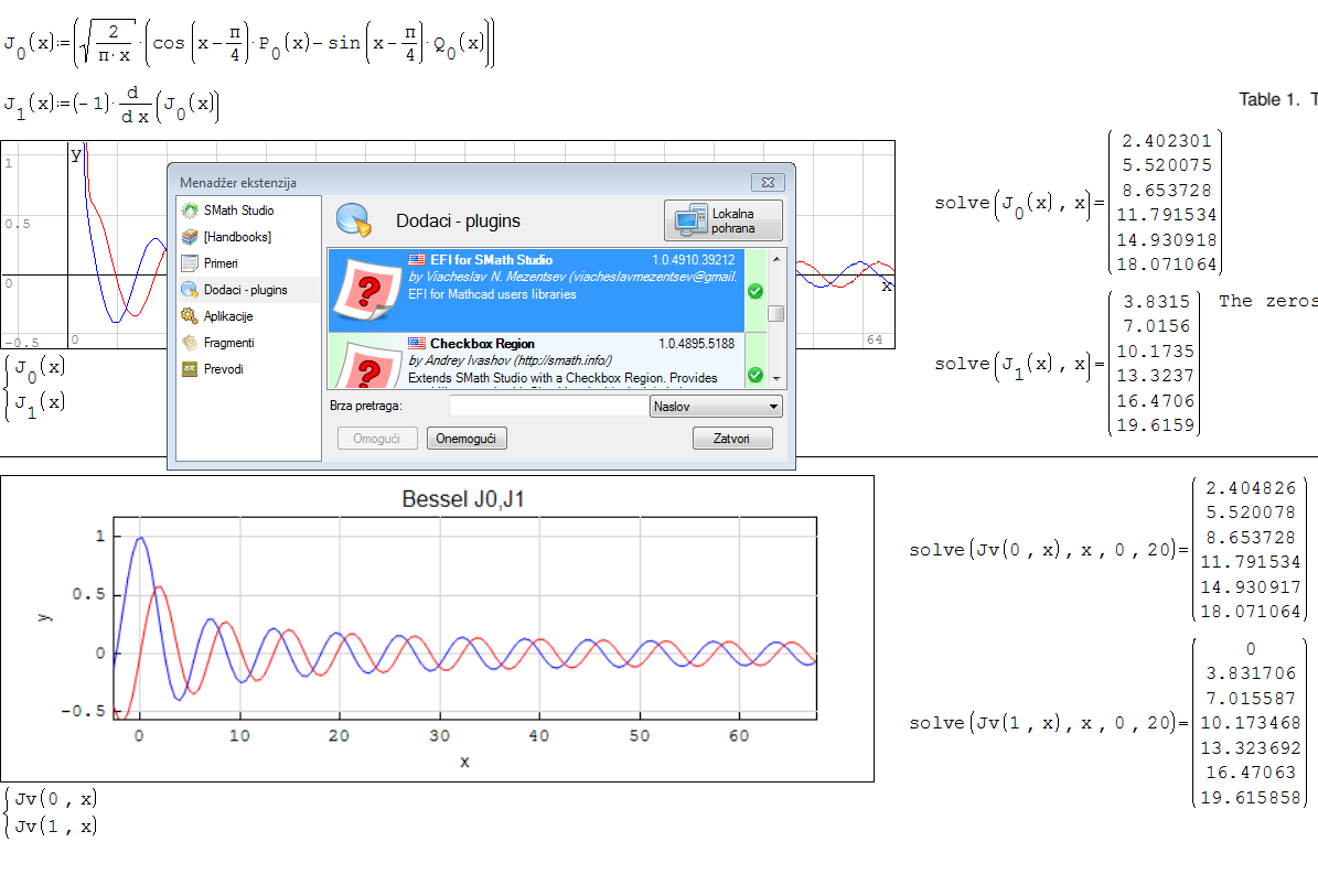

Yes, there is a plugin which includes those special functions (Bessel, Modified Bessel, Integral functions etc.). Mathcad EFI made by uni. I was using them in my teaching few times. Unfortunately, the plugin is not working with the most recent SMath version. I hope that uni will find the way to recompile and put it in the Online Gallery, or expand the existing Alglib in order to include Bessel functions as well.
#5 Опубликовано: 11.06.2013 11:52:17
First: Is there any plugin or function in SMath Studio for Bessel functions?
(Maybe not, at least I didn't find such a thing anywhere.
Done. You must manually copy the mathlib.dll to the userefi folder (".../Application Data/.../91a20d24-c30b-4774-9b1b-4d502a80420f/x.x.x.x/userefi/" ).
mathlib.sm (59,64 КиБ) скачан 1172 раз(а).
#6 Опубликовано: 11.06.2013 13:02:02
Thank you uni
It seems I had a lucky guess this time. I've seen the EFI plugin in the Gallery. Installed it first and then copied the mathlib.dll in the place you mentioned. Bessel and other functions are back . Here is the result using the file by AlphaBeta. By the way, this much faster than using the approximation formulae.

Did you mean on Bessel functions by In,Jn ? Their names are actually Iv, Jv.

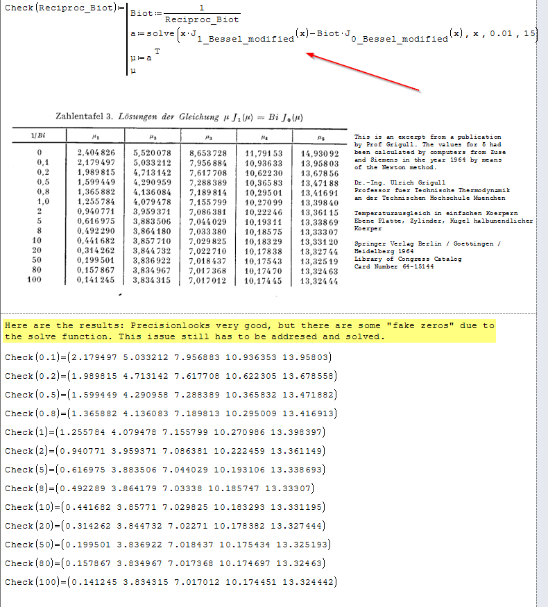

But nevertheless attached you can find my "home-brew"-approach towards the Bessel function.
Actually I only wanted to solve a heat transfer problem.
Now I am a litte bit
Also thanks to M. Kraska.
20130612 Bessel Modified.sm (1023,6 КиБ) скачан 1216 раз(а).
#15 Опубликовано: 12.06.2013 13:30:09
The results from solve() depends on the equation, range and decimal places (Tools|Options|Calculation Decimal places). See the result if you change the equation, give different range and set 15 decimal places.

thank you for your hint. I know that the solve function will produce some "ghost-zeros" in certain cases depending on the function, the range and the precision. I have sorted this out before by means of a little program within SMath using BiSection or NewtonRaphson, or using the initial zeros and then making a second, more refined "solve"-run using closer ranges. Additional knowledge about the functions periodicy is also helpful here.

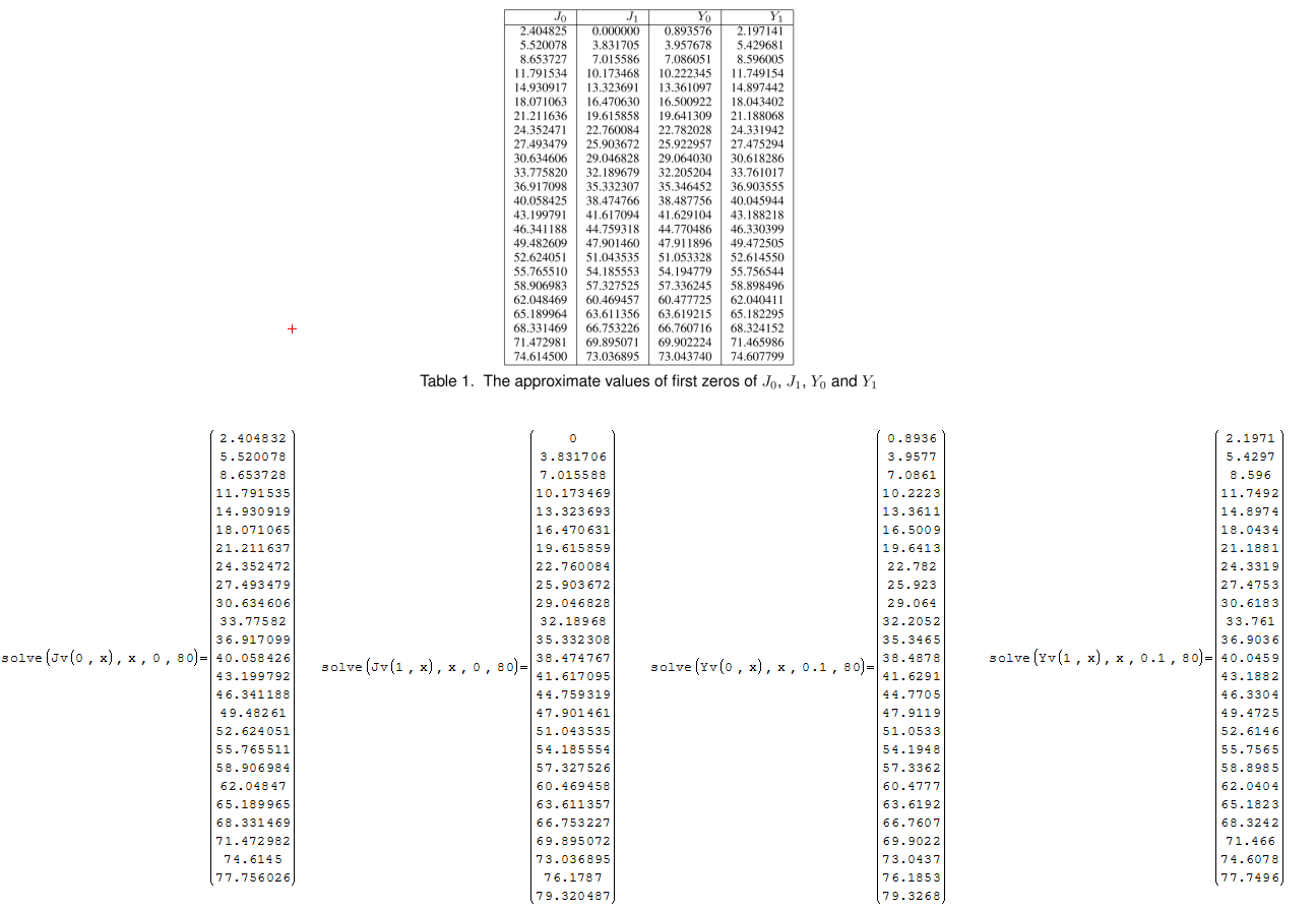

Andrey made solve() and, as he said, it uses some kind of searching algorithm - do not know which one. If you know any algorithm of this kind, or can find some pseudocode on the Net, you can let Davide Carpi know about this (he is developing NonlinearSolver plugin). He alredy made some of "my dreams come true" regarding nonlinear solvers in SMath.

Stay tuned for the new NonlinearSolver, I think Davide "might be" preparing something.
