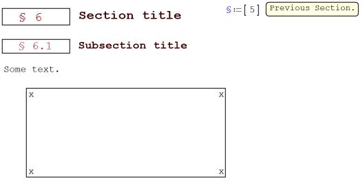

A template about how to create automatic numbering sections, figures, tables and equation labels.

Razonar,
How do you start from paragraph 1? preferably 0?
Thanks,
Basile
PS. Can this be extended to have an automatic Table of Contents, List of Figures, List of Tables, and List of Equations?

WroteRazonar,
Thanks,
Basile
Hi Basile. You can start from any paragraph pointing the value of the variable '§, for example from paragraph six is: '§:mat(5,1,1)
For paragraph 1 use zero as starting value.

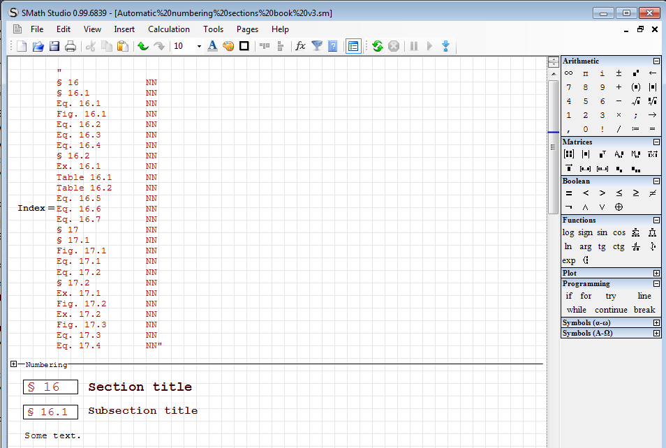

Hi. The One-Function version, with TOC at the end.

Davide Carpi 01.10.2018 03:25:00
You can display the index at the begin of the document if you assign it to an absolute variable at the end (those variables starting with a tilde ~)
On german keyboards, the tilde has to be copied from a text region as it is catched as a hotkey for boolean = in math regions).
BTW, why don't you use formatted labels?

Hi Martin. Thanks for the update about global variables. I don't use formated labels because I want only to show how get automatic numbering into several SMath documents with native SMath tools. Without any doubt with formated labels it will looks great.
The formated label version.
