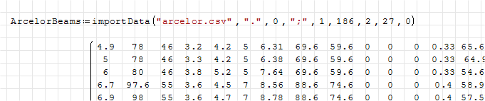

Hi Ioan,
seem there are issues with the first column (the beam type and size); I can not load the column even by enclosing the values in double quotes... except for that other data can be loaded without issues
regards,
w3b5urf3r
P.S. does anyone know the difference between the 3rd and the 4th arguments of importData(9)?

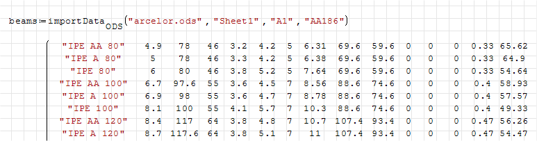

CSV converted with LibreOffice and imported with DataExchange plugin
Best regards,
w3b5urf3r
