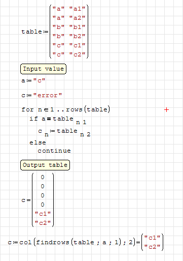

I have a question about creating a new table from existent one. A new table should be created according to matching of input value and values in existent table.
A out of operation example what I want to do you can see below.
Can you please help to solve this issue.

Here are two solutions
[albumimg]367[/albumimg]

Thank you the second solution is work properly.
The first solution show all rows of table, but I need just rows where input value matches with values of first column of table.
Is there possibility to improve first solution?

yes there is;
matrix.sm (4,83 КиБ) скачан 823 раз(а).

Here all three options.
Edit:
I wasn't sure how to setup the timers. They are not correct.
Creating New Matrix.sm (10,63 КиБ) скачан 883 раз(а).
