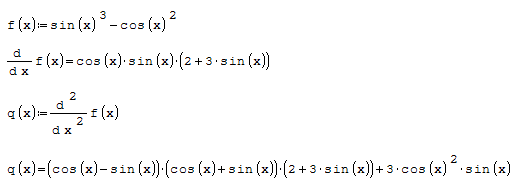

I found small bug in Differential Equations Display.
Simple example:
Calculations are done. But symbolic evaluation do not show the outcome.
The problem is not catastrophic. But I thought it worth it to report it.

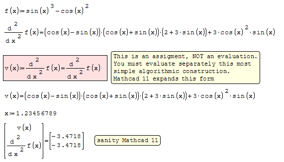

Confirmed: no bug ... your screen is lazy to expand ... if that what you have !

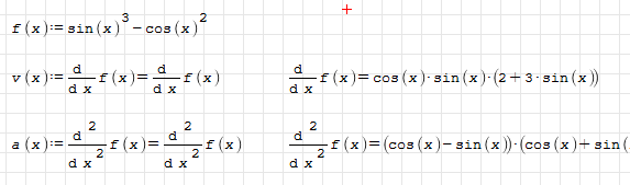

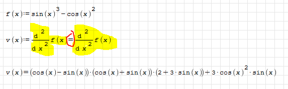

Jean, you misunderstood the "problem".
Not the calculation is wrong.
This is:
As I wrote, it is not big and not a kind it is impossible to live with it.
I am just reporting what I notice.

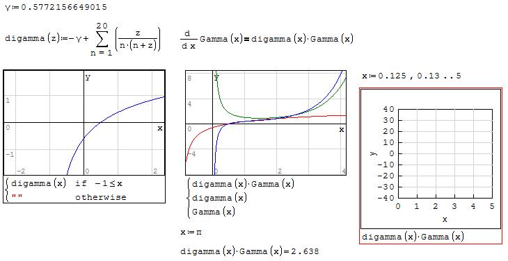

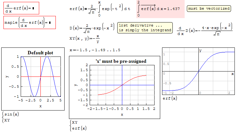

There are few more curiosities in Smath.
In Smath, erf(x) is not a scalar function in the maths sense,
Build the example
and if you get the two red ones, "X-not defined"
that you must read "erf(x) is not scalar" ... Thus:
1. vectorize the integrand
2. Pre-assign the X_Y plot
Example from version 6179

Thank you, [USERLINK]PDG[/USERLINK].
Bug confirmed. Will look at it later.

#8 Опубликовано: 17.06.2018 20:31:41
That one, X_Y refuses plotting at all !

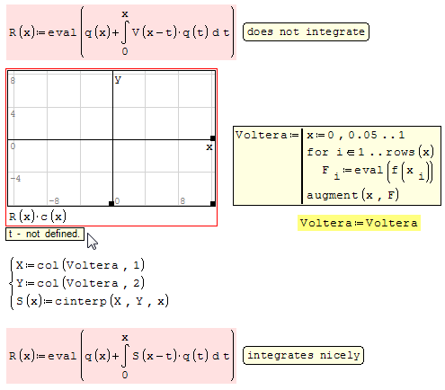

#11 Опубликовано: 18.06.2018 00:32:23
... this is another style of parametric solution.
... a much different style of transit.
At that times my brain diluted on that one !
Takes quite a while before "t_not defined"
Integrate Voltera IntEQUATION.sm (28,22 КиБ) скачан 1267 раз(а).
