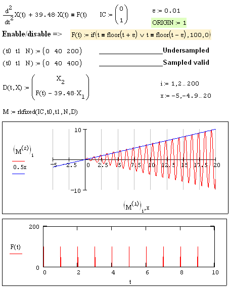

Simple test 2.
DotNumerics.ode.test2.sm (21,23 КиБ) скачан 1673 раз(а).
DotNumerics.ode.test2.pdf (79,99 КиБ) скачан 806 раз(а).

#22 Опубликовано: 01.08.2018 21:57:14
Simple test 2.
Works nice conventional/visual [6179].
That document, if it would come from other designer
would pass my QA [Quality Assurance].
DotNumerics.ode.test2.sm (24,51 КиБ) скачан 1766 раз(а).

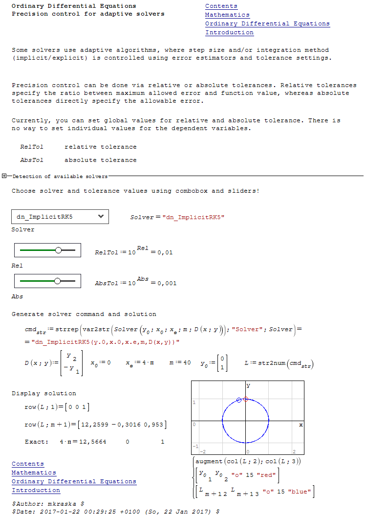

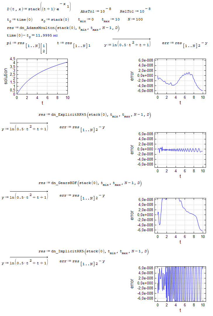

#23 Опубликовано: 09.09.2018 14:23:36
It seems that all the dotnumeric ode solver functions fail to add the last step to the solution. In the given example, the exact solution is (approximately) met if the end value of x is increased by one step (x_end/steps).
The sheet is easily extended to whatever ode solvers by adding their name to the search list. The actually available solvers depend on what plugins are installed.
Section Math ODE precision.sm (23,66 КиБ) скачан 1821 раз(а).

#24 Опубликовано: 10.09.2018 06:48:25
Updated for SS 0.99.6824. Intervals issue fixed.

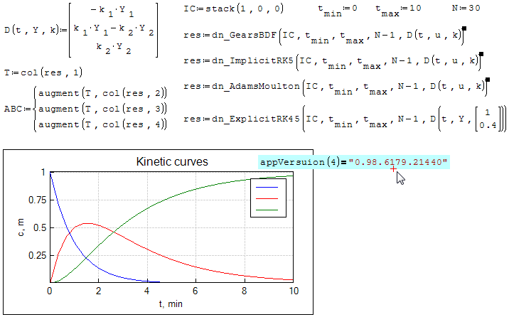

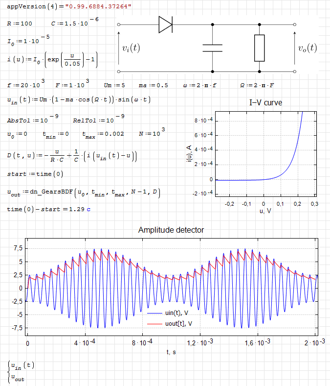

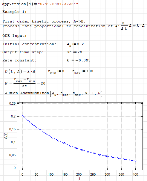

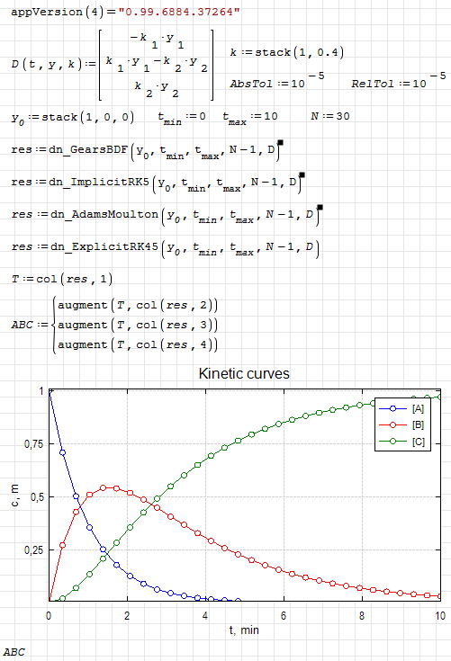

#26 Опубликовано: 24.12.2018 09:13:53
Updated.
2018-12-24_17-06-48.png 2018-12-25_04-33-23.png 2018-12-25_04-34-24.png dn.ode.test2.png dn.ode.test1.png 2018-12-24_17-07-41.png
dn.ode.kinetic1.sm (8,26 КиБ) скачан 1915 раз(а).
dn.ode.kinetic2.sm (12,59 КиБ) скачан 1793 раз(а).
dn.ode.kinetic3.sm (12,28 КиБ) скачан 1845 раз(а).
dn.ode.test1.sm (19,58 КиБ) скачан 1860 раз(а).
dn.ode.test2.sm (18,88 КиБ) скачан 1835 раз(а).
dn.ode.Amplitude detector.sm (20,17 КиБ) скачан 1888 раз(а).
dn.ode.kinetic1.pdf (77,42 КиБ) скачан 1043 раз(а).
dn.ode.kinetic2.pdf (93,05 КиБ) скачан 979 раз(а).
dn.ode.kinetic3.pdf (91,31 КиБ) скачан 963 раз(а).
dn.ode.test1.pdf (115,72 КиБ) скачан 941 раз(а).
dn.ode.test2.pdf (120,44 КиБ) скачан 932 раз(а).
dn.ode.Amplitude detector.pdf (148,87 КиБ) скачан 986 раз(а).

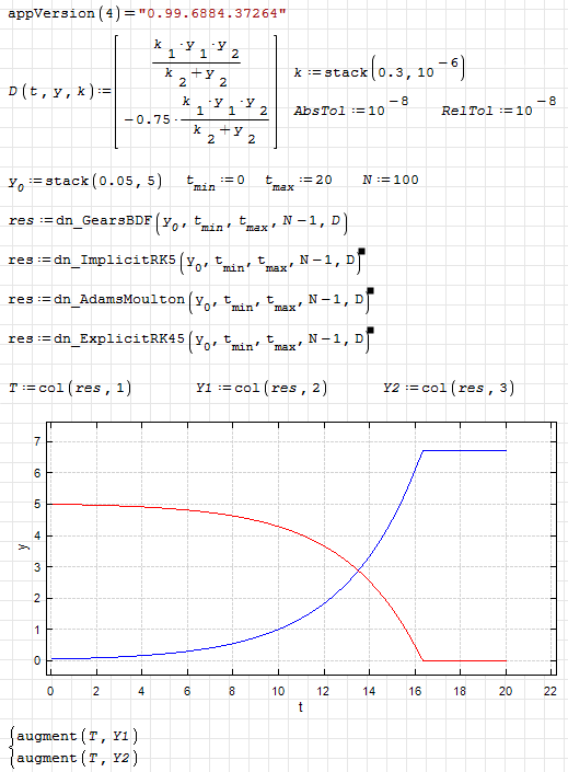

#31 Опубликовано: 21.08.2022 02:43:28
Hi Viacheslav. There are an issue with Implicit and dn_ExplicitRK45, just in the first element. Please see the attached.
dn_ExplicitRK45 issue.sm (8,42 КиБ) скачан 1666 раз(а).
#32 Опубликовано: 22.08.2022 03:12:45
SMath Studio compatibility
Plugin updated.
Changes:
- fixed values of initial conditions in the output array for dn_ImplicitRK5() and dn_ExplicitRK45().
sergio 22.08.2022 04:19:00, Alvaro 23.08.2022 20:15:00
