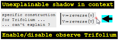

Module xd(L,H,N) has fixed bounds [L, H], 'N' sets the number of calculated values,
including the bounds. It has nothing to do with the "bug". The attached highlights
the bug. Anything you code depend upon invisible/borrowed codes. This one may not
appears in newer versions from newer sub-codes.
Enable/disable => observe the Trifolium plot below.
The Shadow in Context is between the triplet stack(f1,f2,f3) and the residual reverse[v,V4].
Conclusively: should be tested with more recent than SS 6179.
It may suggest to get reverse & stack codes from other sources.
It does not seems to be dependent upon the line code.
