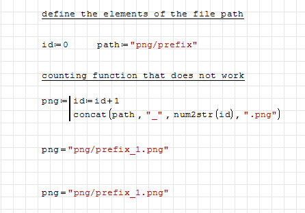

Would anyone know if there is a way to define a variable or a function that increases in value by 1 every time it is called?
I am trying to set up automatic naming scheme for the image output of my excel_PNG plugin. It takes a filepath as an input to be used when saving generated png. What i need is to generate the filepath string which is different every time its called. It also needs to be consistent (i.e it cannot change for a particular function call every time worksheet is calculated) so random() will not work.
Ideas? Unique consistency of the value for a certain position within workbook is s the goal.
Here what i tried, predictably without success.
ID.sm (3,8 КиБ) скачан 821 раз(а).

Thank you, Ioan, this might be my best bet. Not ideal though because it does require my input; I have about 100 calls to excel_PNG in one file, each of the call generates a PNG file, and it can be cumbersome to change the id variable for each of them.
So i take there is no "counter" function in SMath is there?

#5 Опубликовано: 24.02.2016 18:58:06
1 436 сообщений из 2 915 понравились пользователям.
Hello Alex
You can try this: Alex4.sm (11,81 КиБ) скачан 856 раз(а).
findstr(...) is because IsDefined() doesn't work as I expect inside the function, not sure if is a bug or something else.
Andrey Ivashov 25.02.2016 09:31:00, Alexander O. Melnik 24.02.2016 20:26:00, ioan92 25.02.2016 05:13:00

#7 Опубликовано: 24.02.2016 20:15:12
Alexander O. Melnik
Alexander O. Melnik
Hello Alex
Works great, thank you very much! I almost thought it is not possible hehe.
Now I do not quite get how the if() loop works, and why does it work, and why it shall not be equal to -1. Could you walk me through this line of code, explaining what it does exactly?
findstr(num2str(id+1),"+")≠-1
Thanks again, this is very clever and elegant!

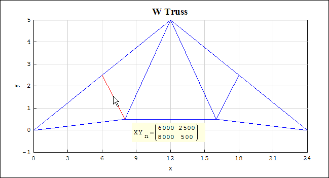

#13 Опубликовано: 25.02.2016 01:30:04
I understand your point of storing dead stuff...
Smath is live for Engineering/Edu/Sciemtific ...
What's the point to read that dead image if the construction is not exemplified ?
There was a long thread on that one, particularly about not a "parrot plot"...
Maybe not yet finished ! ? I admit, humbly, I'm not a "bright spark".

You're welcome
The function uses pass-by-reference to output the value to the canvas via the input argument.
If the input value is an unknown, will be set to 1. This should be done in the if/else statement using the built-in ¬IsDefined(id) that for some reason I have to investigate doesn't works, so I've replaced it with findstr(num2str(id+1),"+")≠-1
num2str(id+1) converts the input in a math string -> id+1 will be converted in a number and then in a string if the input argument is a number, otherwise will be "something+1" where something is the name of the input unknown in the canvas (because id is a local name that contains the variable passed from the canvas -> a simple num2str(id)≡"id" is not possible); in the first case, findstr will returns -1, because the string contains a number, in the second case will returns a vector that contains the index of each "+" match. Hence if findstr(...)≠-1 -> the variable is not a number, set it to 1, otherwise increment by one.
