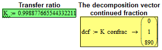

Many Greetings
Has anyone made a function in Smath for factoring a number into a continued fraction, similar to making the symbolic function K confrac in MathCad?! Where K represents a fractional decimal number, as in the example in the attached image.

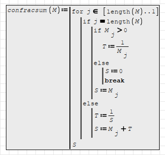

Below is a function to sum matrix of confrac().
ioan92 10.12.2023 18:45:00

Thank you very much for the answer. I arrived at a very similar relation, but which did not work because I omitted to declare the function variable at the beginning of the program in the right member of the definition relation. Using MathCad quite often (where the variable / variables of the function are automatically declared only by mentioning them in the left member of the definition relation) I tend to apply the same rules in Smath. Thank you again.
Greetings.

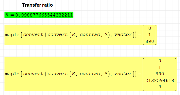

#7 Опубликовано: 10.12.2023 23:38:59
Has anyone made a function in Smath for factoring a number into a continued fraction ...
Yes, in most advanced profitable.
Best to save a copy before experimenting
Jean.
ConfracNUMBER Copy.sm (46,11 КиБ) скачан 1368 раз(а).

@uni: The advantage of the relationship is that it takes up little space in the worksheet. The disadvantage of designing such a relationship is that the component functions (convert, confrac, vector) are not predefined anywhere in the program's toolbars (at least not in the version I have). Maybe in newer versions there are predefined functions for these functions.
