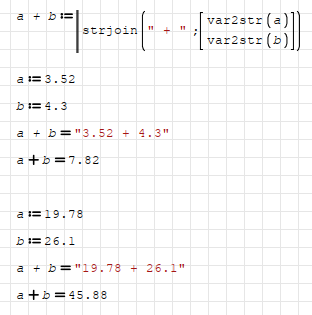

#6 Опубликовано: 23.10.2021 16:29:43
Hi. This is another way.
intermediate_results.sm (14,4 КиБ) скачан 1151 раз(а).
sergio 24.10.2021 16:26:00
#7 Опубликовано: 23.10.2021 17:59:30
DeepButi
DeepButi
That looks exactly as I was looking for ... going to study it. Thks a lot, it will save me quite a bit of time.

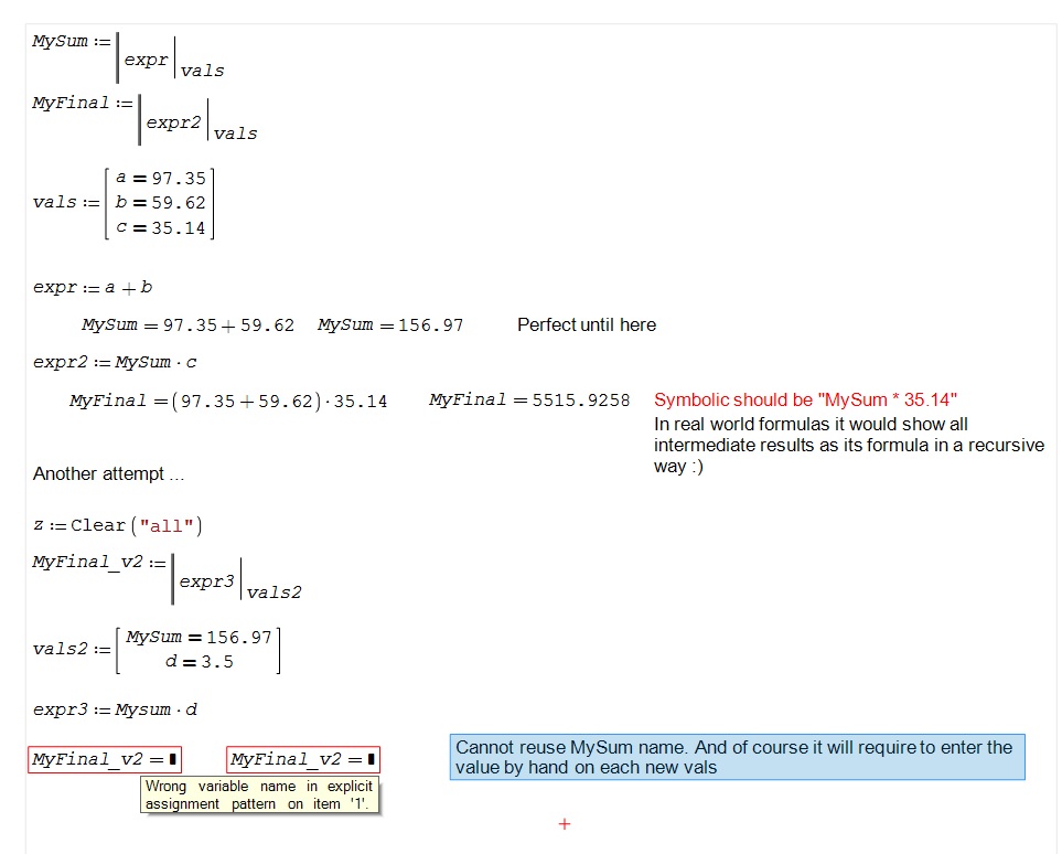

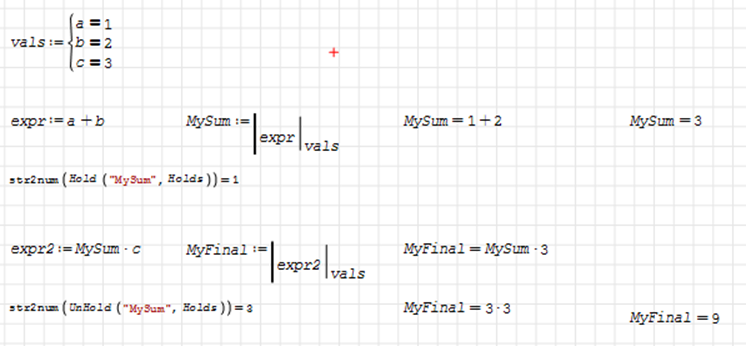

#8 Опубликовано: 24.10.2021 16:00:36
DeepButi
DeepButi
Hi Razonar,
it works perfectly well for initial formulas, but cannot find any way to use a previous result on a new one.
Cannot put all values in a single vals, the simbolic substitution will show in the second formula the formula (not the value) of the calculated value (ee).
Cannot either reuse names.
Any idea?
#9 Опубликовано: 24.10.2021 22:10:44
Any idea?
I have an idea, if someone has better you can use it.
Rewrite expressions and hide them inside areas.
Configure page setup with "no areas".
When you save as pdf or print, it will show as continuous.
MySum.sm (8,16 КиБ) скачан 1155 раз(а).
But here is a humble suggestion.
SMath was not coded with intent to show intermediate results.
You are going to struggle very much with this approach.

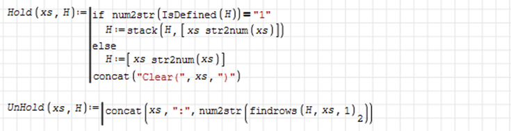

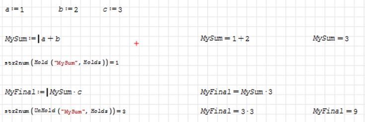

Hi. This is another way. The feature request actually is here.
Using
You can get
Hold.sm (9,78 КиБ) скачан 1153 раз(а).
or
Hold_v2.sm (9,06 КиБ) скачан 1153 раз(а).
sergio 25.10.2021 14:18:00

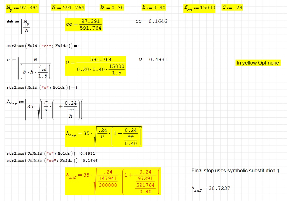

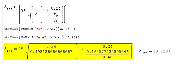

#12 Опубликовано: 25.10.2021 18:31:25
DeepButi
DeepButi
Too easy to be true Final step uses fractions to substitute ... Use a:=1.2 in your example and you will see.
Actual formulas are for sure more complex so the data display is really confusing.

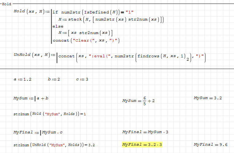

#13 Опубликовано: 25.10.2021 21:06:10
Hi. Insert eval( ) in UnHold
#14 Опубликовано: 26.10.2021 05:48:01
DeepButi
DeepButi
You are a genious. Thks!
Just trying to figure out how to avoid too many decimals now
Decimal places set to 4 everywhere
#15 Опубликовано: 26.10.2021 12:21:13
Hi. Thanks! ... but ... not ... but thanks. That behavior seems to be a bug or an oversight: set the decimal places in the output of an expression with None Optimization.
In the meantime, this could be a workaround, but could be dangerous, because change the stored value. Actually I don't really recommend it.

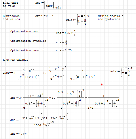

#17 Опубликовано: 27.10.2021 02:25:12
John Heidenreich
John Heidenreich
5 сообщений из 67 понравились пользователям.
Ok, ok. Really it's a BIG THANKS.
:round(eval(... works perfectly well
:eval(round(... didn't.
Another way...
