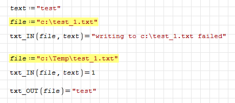

It seems that there is a problem with this plugin:
I'm working on SMath Studio 0.997822

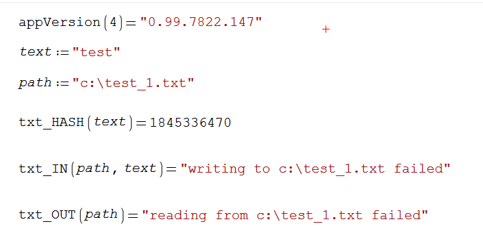

Sorry... I updated the plugin, but it seems that the problem continues:
#6 Опубликовано: 10.07.2021 12:03:41
Try a different folder. Writing to the root folder is prohibited.

Thanks, UNI! the little details make the big differences!
