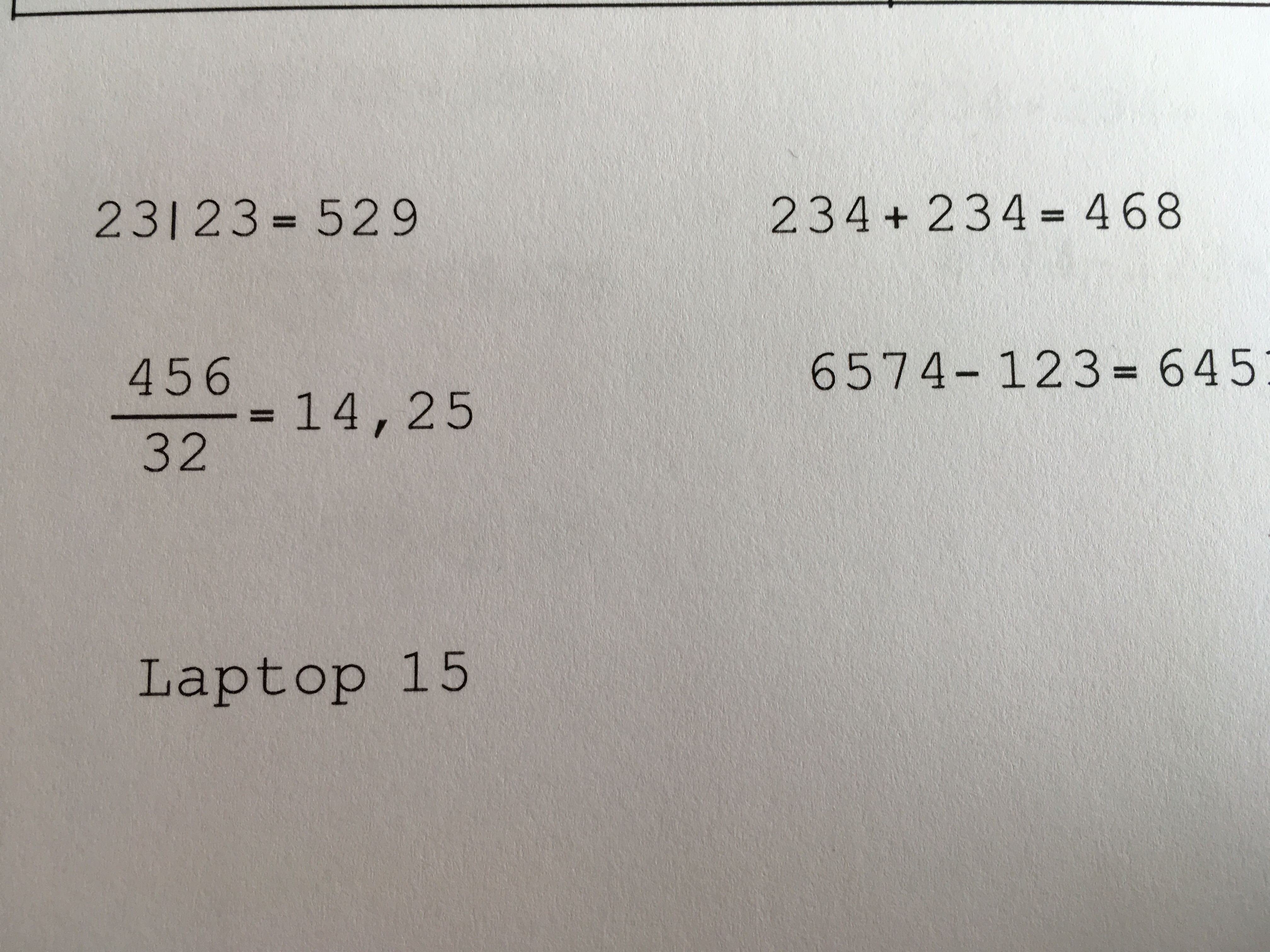

Hello everybody,
when my students print their SMath files it appeares that some of the printouts does not show the arithmetic operator fro multiplication "*" but instead the "|" line instead.
I did install the program from USB-stick, so all laptops have the same version. After install we did not alter any setups. And all Laptops print 2 the same printer. And further are all laptops of the same type/modell including OS (Win10).
Any suggestions, why some prints show the arithmetic operator and others not...?

#10 Опубликовано: 30.04.2018 07:53:57
DirkOS
DirkOS
Any suggestions
Rather questions:
1. 2.5 MB for 4 simple arithmetic ?
2. What generates the gray background ?
3. Is that what it prints ? Visibility is around 7 % zoom down
4. Check the keyboard style as well.
Sry for the unconvenience, i took a picture!
#11 Опубликовано: 30.04.2018 09:37:51
DirkOS
DirkOS
Hello Everybody,
issue solved by reinstalling on all computers!
Thank's for respone and help!
