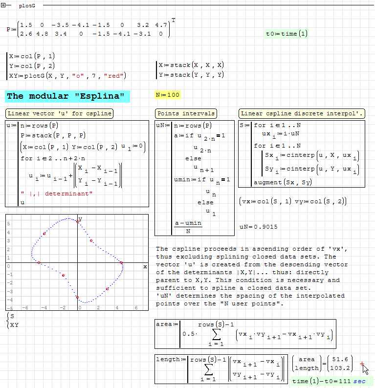

This one works well for the given data set. Mesh finer at will and if needed,
bilinear ... not much use for bilinear, whereas "spline" is just something.
Spline Esplina [AI2000].sm (23,66 КиБ) скачан 1148 раз(а).
#2 Опубликовано: 12.09.2016 19:08:01
... a faster version: one twin col extractor removed.
By same token, I wonder why the col extractor col(,,) is so slow ?
Spline Esplina [AI2000].sm (23,75 КиБ) скачан 1172 раз(а).

Thanks Ber7 for "speedy Gonzalez". In fact, the "uN"
conditional code is redundant in this dataset.
Here is the latest version, even faster.
Spline Esplina [AI2000].sm (23,66 КиБ) скачан 1193 раз(а).

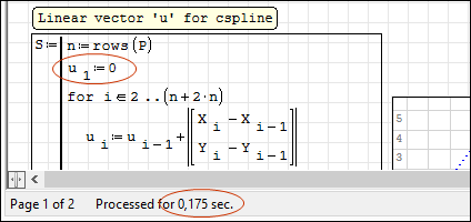

You forgot to specify first element of u vector.
By doing so you can speed up calculation even more:
Regards.
Davide Carpi 13.09.2016 11:45:00, NDTM Amarasekera 13.09.2016 12:01:00
#8 Опубликовано: 13.09.2016 12:08:37
Thanks Andrey, damned me !
