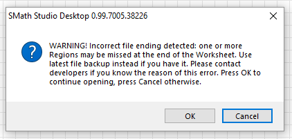

#5 Опубликовано: 07.03.2019 15:39:15
Related improvement introduced in build 7005: when SMath Studio detects similar errors it now shows the following message:
Program shows only available content if user presses OK.
frapuano 07.03.2019 18:29:00
